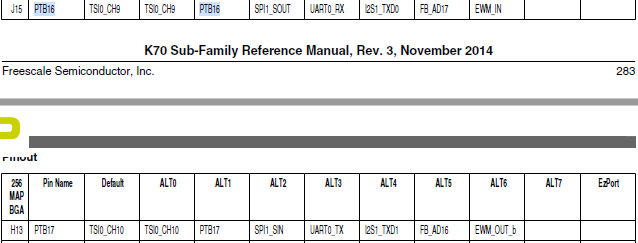

Hi  Vibhu:
Please refer to the K70 data sheet , PTB16 AND PTB17,   UART0_RX and UART0_TX is ALT3, but in you orignal post, ALT is 4, that 's wrong.

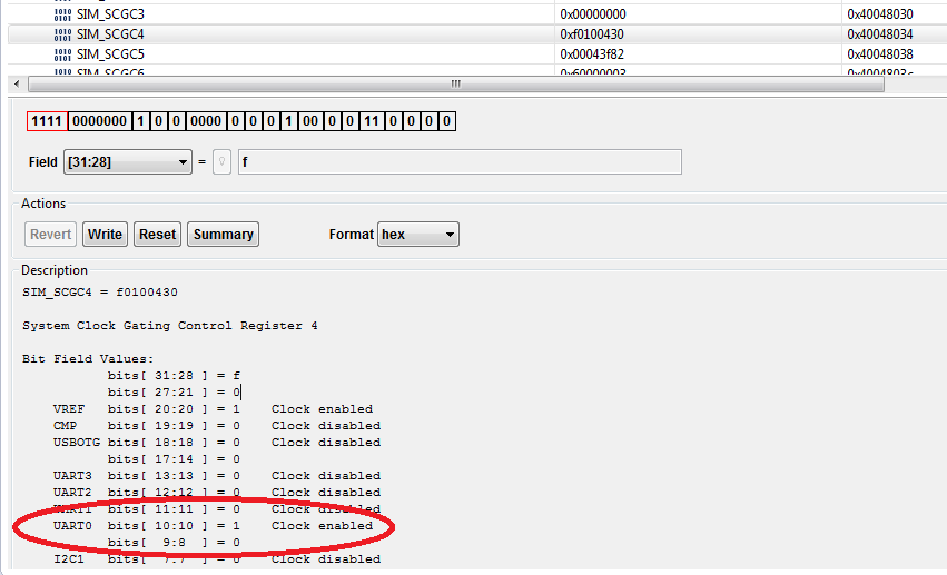

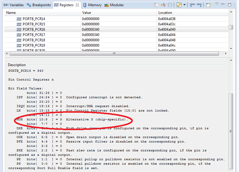

danielchen
Hi Vibhu:
You can check the register settings:
For PORTB_PCR16 and PORTB_PCR17,  MUX bits:   Alternative 3.
For SIM_SCGC4 :  uart0 clock enabled.
