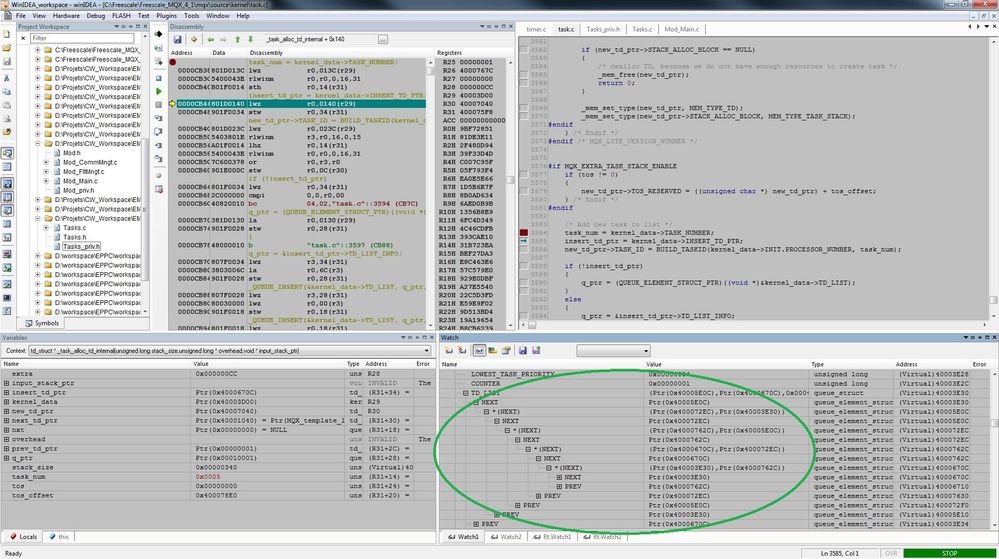

I did a little application which has 3 tasks. One init task and two other tasks that I want to make cyclic. To do so, I create a periodic timer for each of my cyclic tasks and I pass the corresponding task descriptor pointer as timer callback function parameter. I did a test with one init and one cyclic task and it worked fine. Now with two tasks, it doesn't work at all, the task are not made ready by the timer callback function.

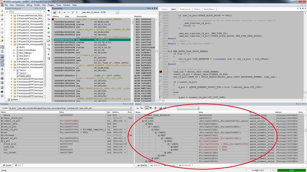

I tracked down the problem and I found out that when I call _timer_start_periodic_at() it create a timer task. In this creation of the task the function _task_alloc_td_internal() is called in file task.c. At line 3585 INSERT_TD_PTR pointer is copied into a local pointer (insert_td_ptr = kernel_data->INSERT_TD_PTR;). This line corrupts the TD_LIST in kernel data:
Before execution of line 3585 (TD_LIST is OK):
Before execution of line 3585 (TD_LIST is not OK):
I don't understand why this line does that because it should only modify a local variable. This variable is a pointer but the pointed value shouldn't be modified...

Seems that the small stack size of startup task is the problem. Works better with 1000 instead of 100.
Hugo
