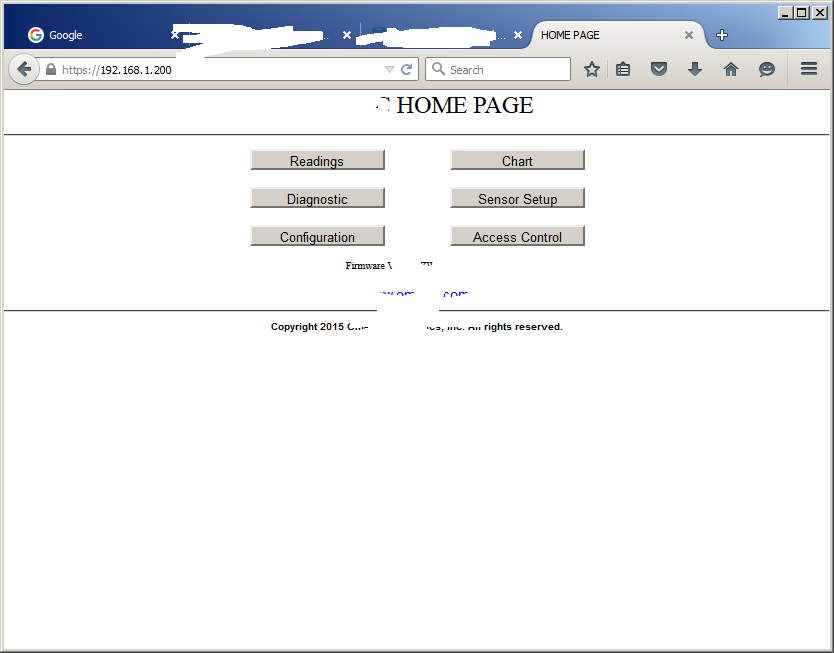

  1. Loaded our main page:

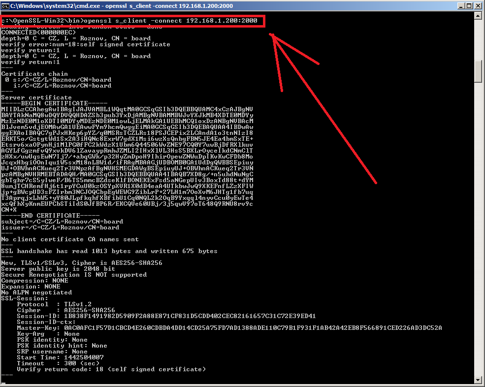

2. I then successfully established a connection on port 2000 using openssl s_client application as seen below.

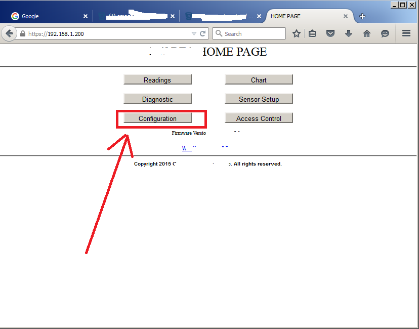

3. I then clicked on configuration button as seen below.

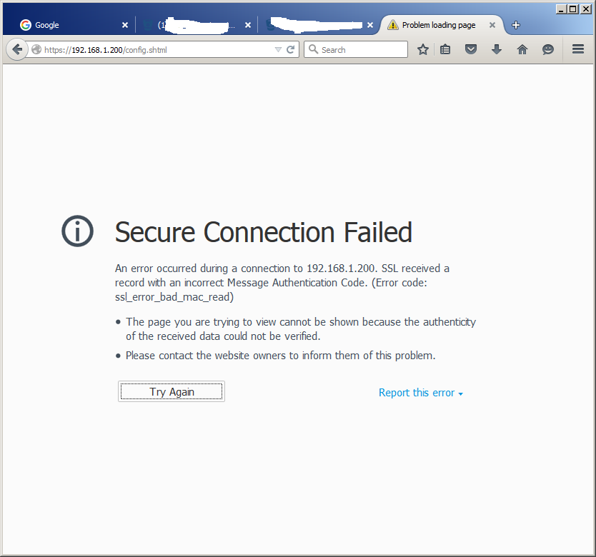

4. After I clicked on the link, I get the following error from firefox.

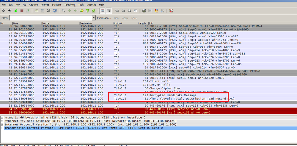

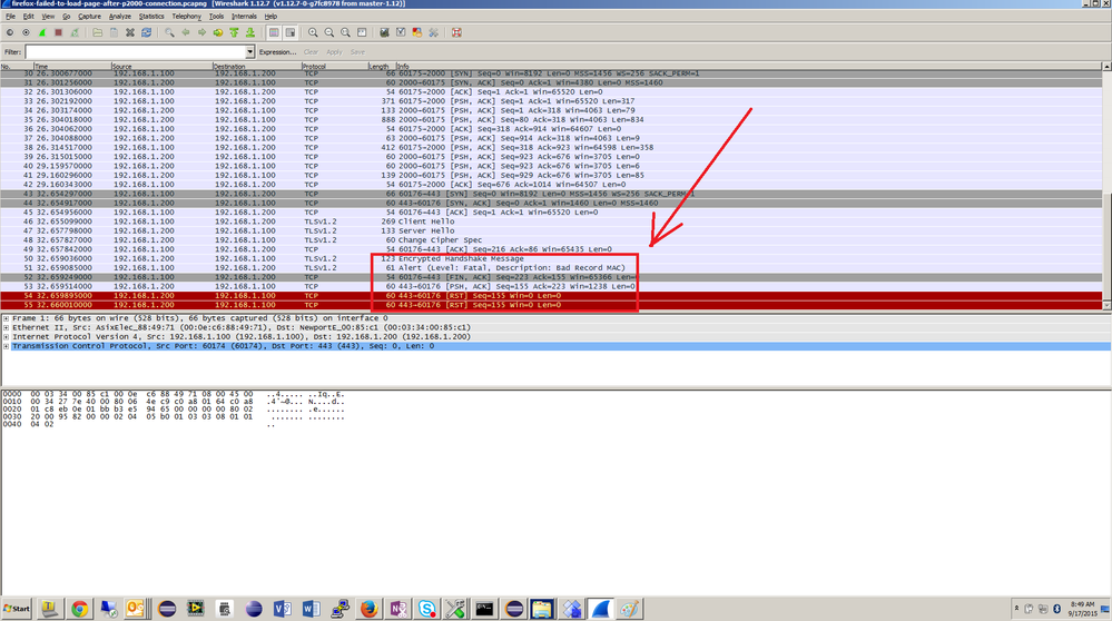

5. While all of this is happening I have a wireshark trace running, below is where I think the error is happening.  I have attached the wireshark trace to this email, if you didn’t get it please let me know as soon as possible.

WolfSSL got back to me on the problem.  Essentially they told me that the handshake negotiation was failing because we were not generating a random key like we were suppose to.  The issue had to do with MQX's 4.2.0 Cyassl Distribution of code using the default "stub" function for the seed generation, i.e., frdm-k64 demo of https is using the following code for generating the seed:
int GenerateSeed(OS_Seed* os, byte* output, word32 sz)
            int i;
            for (i = 0; i < sz; i++ )
                output[i] = i;
            return 0;
Which as you can see is not random and was causing the "bad MAC" errors.  So I ended up using the following:
