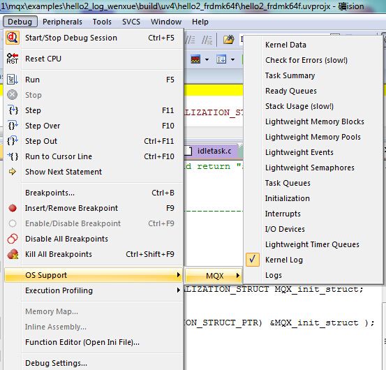

wenxue
Thanks! It's useful.
But I have a question, because customer used Keil IDE, but I found it don't have “Save Performance Data” option. So I can't use Mqx TOOLs menu in Codewarrior. Do you have any good idea for this case?
