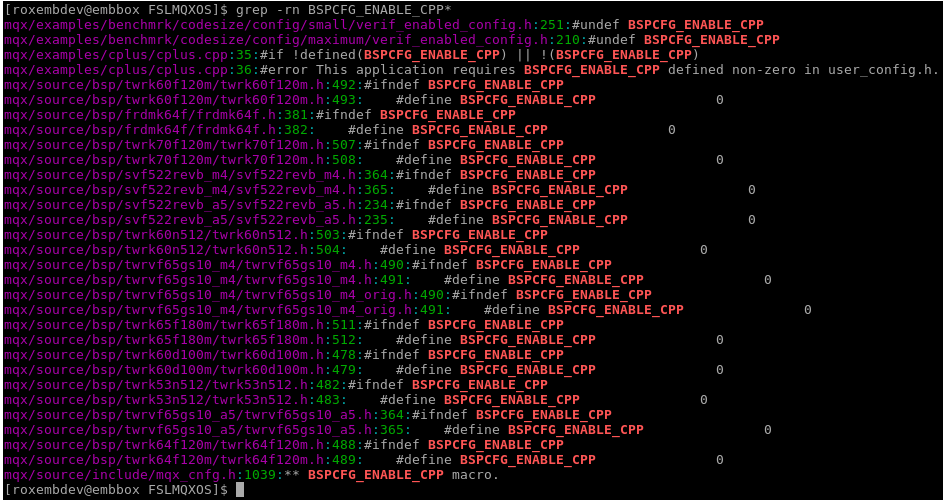

The MQX's cplus example uses macro BSPCFG_ENABLE_CPP as a compile check for CPP support, but what is it used for by MQX sources, if at all?
I looked (grep'ed) through the MQX sources, and I can't see BSPCFG_ENABLE_CPP or MQX_ENABLE_CPP used by anything for anything.
Does it do anything for the code?
(Also found this thread: https://community.nxp.com/message/349610?q=cpp ; it seems C++ support hasn't moved on it since 2013?)

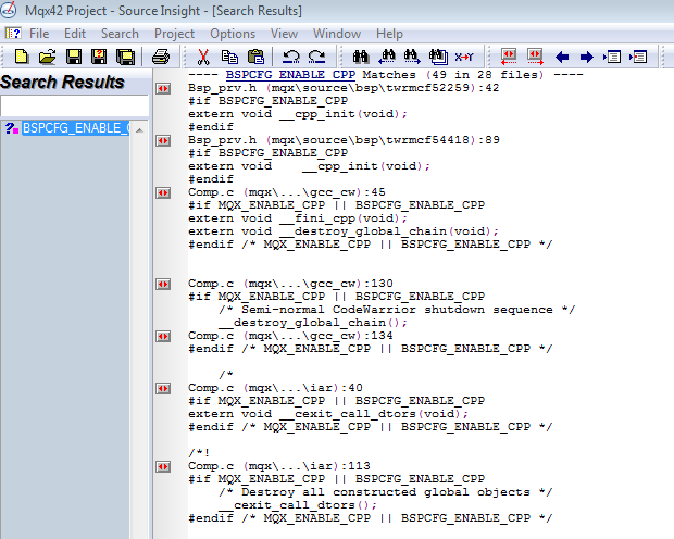

Hi D.RY
I did a quick search on the BSPCFG_ENABLE_CPP through MQX 4.2 sources, and I can hit lots of matches. I would suggest you update to the latest MQX version and try it again.

Hello Daniel,
I looked at the output of your screenshot, and tried to look for some of those directories.
And, for example, mine installation of MQX 4.2 does not even have mqx/source/bsp/twrmcf52259 (second line on your screenshot), and similarly for next one I checked.
I'm curious which installation of 4.2 MQX you used. Once difference I see it seems a Windows install.
But must be something else, could be we have totally different install files?
I believe I used these - Linux base & applied the patches

1,620 Views
dry
Senior Contributor I
Hmmm, I believe I have MQX 4.2.0 , patched with 4.2.0.1 and 4.2.0.2 patches.
When I search for BSCFG_ENABLE_CPP i only get hits on headers, where its defined, but no useful payload with it like I see you have in your screenshot.
