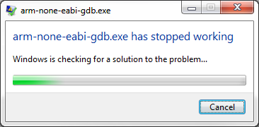

The problem I have is that when this code is executed with a breakpoint set (or if a breakpoint is added after execution), the debugger crashes:
This behavior is consistent with the known behavior where GDB crashes if a breakpoint is set in code that never gets called by the application.  This implies that I'm not setting something up properly, but I do have the preprocessor setting "MQX_EXIT_ENABLED=1" in my project settings.
