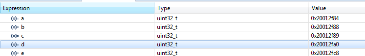

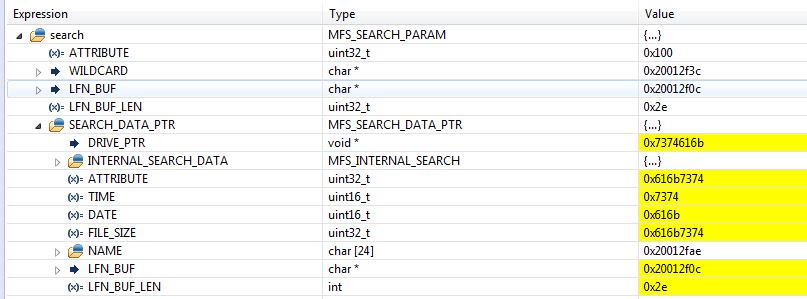

A look at the addresses of the structure before and after the function call:
Just before the call to error_code = ioctl(a_fd, IO_IOCTL_FIND_FIRST_FILE, &search);
(Had to create variables to read addresses because the Expressions window was giving a different value than when I did a mouse over). These values are from MFS_SEARCH_PARAM.
 a = (uint32_t)&search.SEARCH_DATA_PTR->INTERNAL_SEARCH_DATA.WILDCARD;
 b = (uint32_t)&search.SEARCH_DATA_PTR->INTERNAL_SEARCH_DATA.ATTR_ONE_MASK;
 c = (uint32_t)&search.SEARCH_DATA_PTR->INTERNAL_SEARCH_DATA.ATTR_ZERO_MASK;
 d = (uint32_t)&search.SEARCH_DATA_PTR->INTERNAL_SEARCH_DATA.DIR_CHAIN_LOC;
 e = (uint32_t)&search.SEARCH_DATA_PTR->LFN_BUF;  =  0x20012fc6

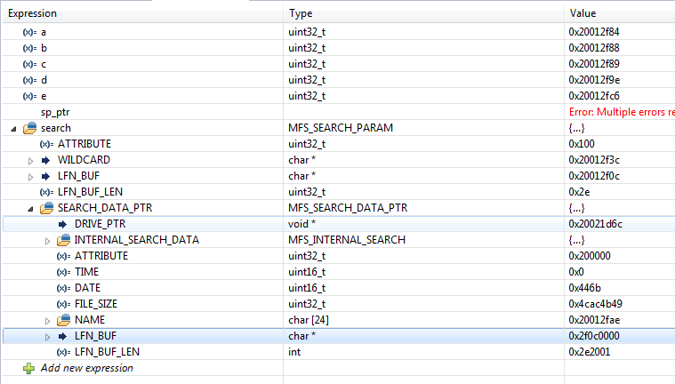

After stepping into the file mfs_find.c and function _mfs_error MFS_find_init(    MFS_DRIVE_STRUCT_PTR drive_ptr,
    MFS_SEARCH_PARAM_PTR sp_ptr,
    MFS_SEARCH_DATA_PTR sd_ptr):
The sp_ptr pointer is pointing to the same address as "search" from above.

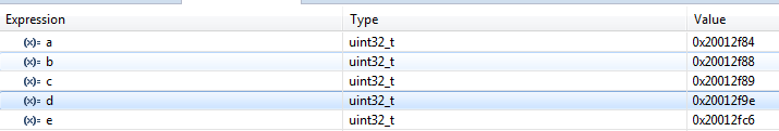

a = (uint32_t)&sp_ptr->SEARCH_DATA_PTR->INTERNAL_SEARCH_DATA.WILDCARD;
    b = (uint32_t)&sp_ptr->SEARCH_DATA_PTR->INTERNAL_SEARCH_DATA.ATTR_ONE_MASK;
    c = (uint32_t)&sp_ptr->SEARCH_DATA_PTR->INTERNAL_SEARCH_DATA.ATTR_ZERO_MASK;
    d = (uint32_t)&sp_ptr->SEARCH_DATA_PTR->INTERNAL_SEARCH_DATA.DIR_CHAIN_LOC;
    e = (uint32_t)&sp_ptr->SEARCH_DATA_PTR->LFN_BUF;

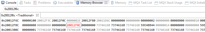

In sp_ptr->SEARCH_DATA_PTR->INTERNAL_SEARCH_DATA.DIR_CHAIN_LOC you can see that address of this element of the structure MFS_SEARCH_PARAM is two bytes different than in search.SEARCH_DATA_PTR->INTERNAL_SEARCH_DATA.DIR_CHAIN_LOC (0x20012f9e vs 0x2001fa0)
When the line sd_ptr->LFN_BUF = sp_ptr->LFN_BUF; is reached (in MFS_find_init()) it copies the filename to 0x20012fa0 and when it returns to the calling function the variable “search” looks for the filename in 0x20012f9e resulting in a shift of the contents of LFN_BUF.

Solution: I recently split my .h files into prototype.h and struct.h because I was having problems with circular references.  In my new struct.h file I added an #include for another .h file which contained a #pragma pack(1) directive.  This would have been ok except there was not corresponding #pragma pack() to turn off the packing so my new .h file inherited the pack command and the MFS_SEARCH_PARAM search and MFS_SEARCH_DATA search_data were packed to a one byte alignment. Unfortunately the mfs.a library file had the default alignment, so this is what caused the alignment problem. I changed to using the #pragma pack(push, 1) coupled with a #pragma pack(pop). This cleared up the alignment problem.
