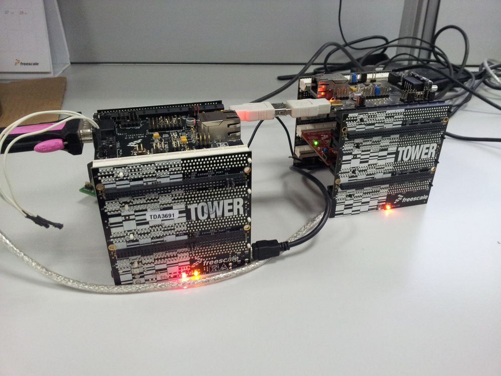

After you download code into, for example, TWR-K70F120(Host) and TWR-K60D100M(Device), and assemble them with TWR-SER and TWR-ELEV, you may connect them via USB port as below:
Please also pay attention to J10(USB VBUS Select) and J16(USB Mode Select) according to the function of each tower system.
With HyperTerminal connected with TWR-K70F120M system, you may type in any charactor ended with ENTER, and you will see the charactor echoed back as the attached video.

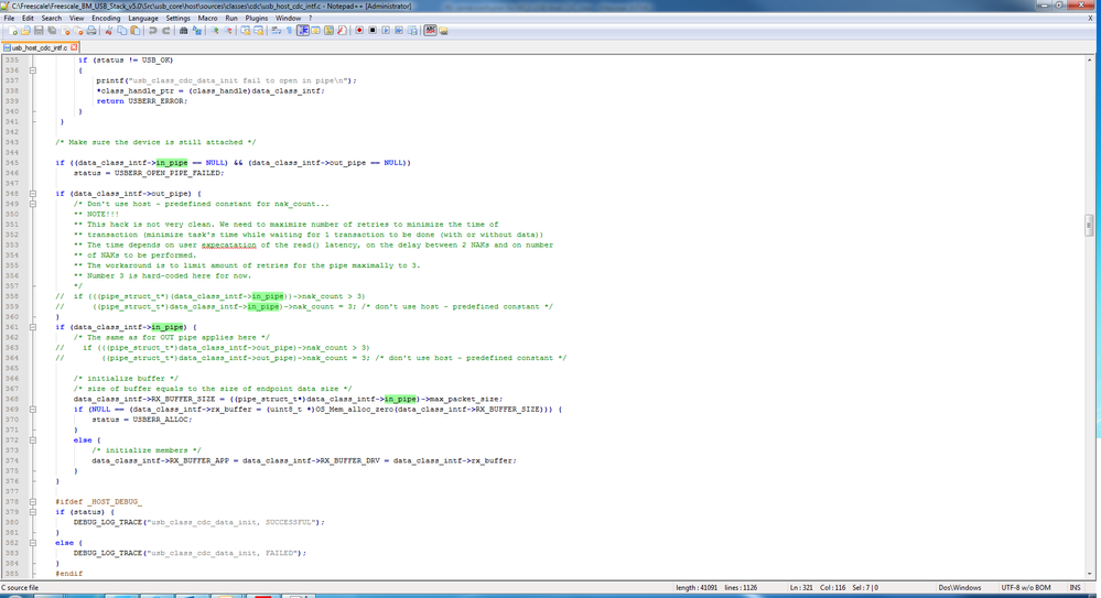

HI, thanks for this, it has been very helpful! I have application code I am porting to MQX 4.1 and the file pointer error was causing me a problem.
I have spotted what I think may be another issue - in usb_host_cdc_intf.c at lines 222 and 209 i think the behavior for in and out pointers have been swapped - if I am interpreting correctly it now only allocates an rx buffer if the pipe is outgoing... which doesn't seem right.
Hi Chris,
Yes, I think this piece of code is wrong.
In our new USB stack, this part should be:
Kan
