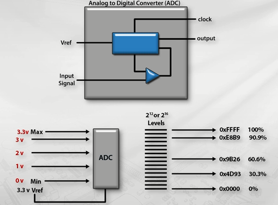

Quick overview of ADC
ADC is a system that converts an analog signal into digital signal. Simply put, Analog signals here means any variable voltage that is being monitored. It doesn’t matter what the signal is doing, it can remain the same level continuously, it can have slight wave to it, or it can be seemingly random. The analog to digital converter requires you to provide the reference voltage. That defines the maximum level that the input can be.  To determine the voltage level of the input the circular ADC generate a local voltage, and just this level until the same level as the input.
This can be done in different ways but the circuitry will adjust the level of the local signal until the comparator to detect the two inputs are the same or lease the same as the resolution of ADC, once the signal level is matched, the output generated.  Which can be read by your application.  To calculate the signal level the ADC defines the full range from the input into the three levels.  ADC typically have a resolution of 12 to 16 bits, so the 212  to 216 different levels. Whatever level input signals determined to be add , the reading from the ADC will be a digital representation of this value compare the  reference voltage. The digital output then represents what percentage of the allowed input range the input signal is currently add.
Being at the minimum level will result an output of zero and being the max will resut in an output of 0xffff. And for inputs some in between the result is the output that represents the level measured. So if you are using a reference voltage of 3.3V for example, the reading will represent what flection the 3.3 v  the input voltage is .  If the input voltage is zero.  The reading will be 0 of course. And if the input is 3.3 v, the reading will be all FF, meaning 100 percent.
So in between, if the input voltage is 1v, the result will be roughly 30.3%. And an input of 2v, will result the input roughly 60.6%, and 3v will be 90.9%.

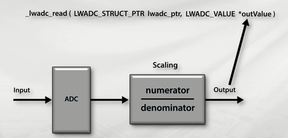

4 _lwadc_read_raw ()
Read the current value of the ADC input and return the result without applying any scaling.
5 _lwadc_read ()
This function reads the current value of the ADC input, applies scaling according to preset parameters.

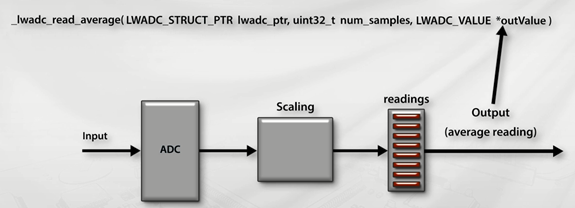

6 _lwadc_read_average()
This function reads num_sample samples from the specified input and returns the scaled average reading.
