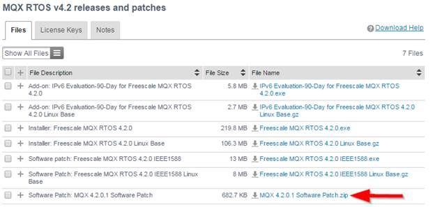

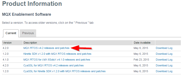

To get the patch:
1. Visit http://www.freescale.com/mqxrtos
2. Click Download
3. Log-in to Freescale.com if you have not done so already.
4. Click MQX RTOS v4.2 releases and patches
5. Click to download the 4.2.0.1 patch zip file.
6. Extract the files
For instructions on how to apply the patch, please consult the release notes.
