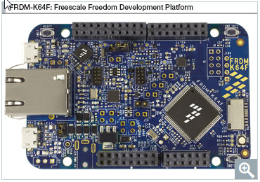

1. Obtain a FRDM-K64F Freedom development module from Freescale or a Freescale-authorized distributor (Details at www.freescale.com/frdm-k64f).
2. Plug in the USB cable for the debug connection and the Ethernet cable for the network connection between the board and your computer.

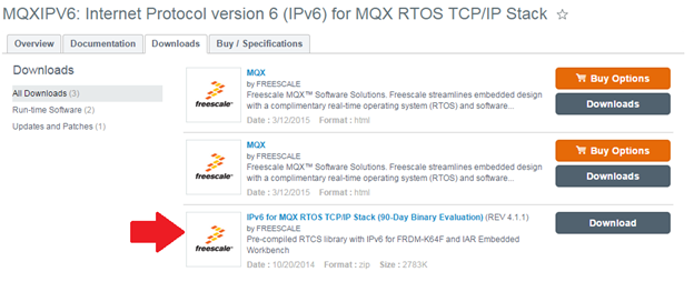

5. Now get the evaluation package.  Go to www.freescale.com/mqx/ipv6.
6. Click the Download button, or download tab
7. Click IPv6 for MQX RTOS TCP/IP Stack (90-Day Binary Evaluation)
8. Read the software license agreement.  If it works for you, click I Accept.
9. After you accept, the zip file (e.g. Freescale_MQX_4_1_1_IP6_EVAL.zip) will download.

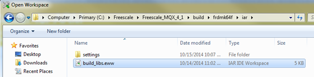

11. Build the BSP, PSP, RTCS, MFS, and SHELL libraries for FRDM-K64F
  a. Open IAR Embedded Workbench
  b. Go to File…Open…Workspace.  Browse to <Freescale_MQX_4_1>\build\frdmk64f\iar
  c. Open build_libs.eww

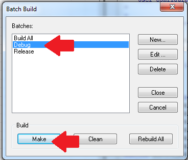

12. Got to Project…Batch Build…  (or press F8)
Choose Debug
Note, if you are trying to achieve the smallest code size, choose Release instead.
Click Make
Note: Even though this evaluation provides separate pre-compiled RTCS and SHELL libraries enabled with IPv6. Building RTCS and SHELL is needed to copy over RTCS header files into the appropriate \lib\ folder, which is referenced by application projects.
    Wait for the libraries to finish building.

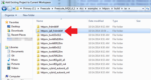

     Select Project...Add Existing Project... and browse to
<Freescale_MQX_4_1>\rtcs\examples\httpsrv\build\iar\httpsrv_ip6_frdmk64f
14. Double click on the project name httpsrv_frdmk64f

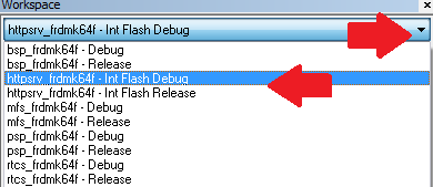

Note: If you chose the Release option in the library builds:
Right click on the dropdown box above the project explorer and select the Int Flash Release.  Otherwise chose Int Flash Debug, which is the default.
15. Choose Project… Make (or press F7) to build the project

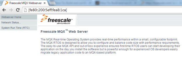

19. Now open a web browser
20. Type in the Ipv6 address of the board surrounded by brackets [fe80::200:5eff:fea8:1ca].  The webpage served by the board should appear.
21. You’re done.  You can now try out the shell example or use the Ipv6 evaluation library to evaluate it in your own application.  See below.
