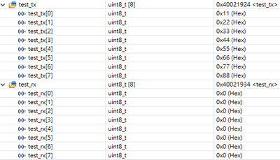

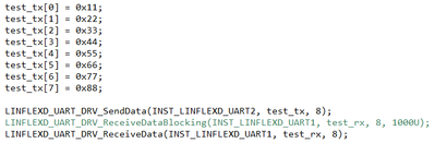

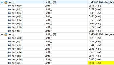

Hi :
There's a problem if I use LINFLEXD_UART_DRV_ReceiveData function in 5746R, it won't receive any data when it run to the breakpoint first time, and if it keep running, the sequence of data in TX bfr is wrong(fig. 1 2 3). Please tell me how to figure out it, thanks.

try to swap send/receive functions, like below...
LINFLEXD_UART_DRV_SendDataBlocking
