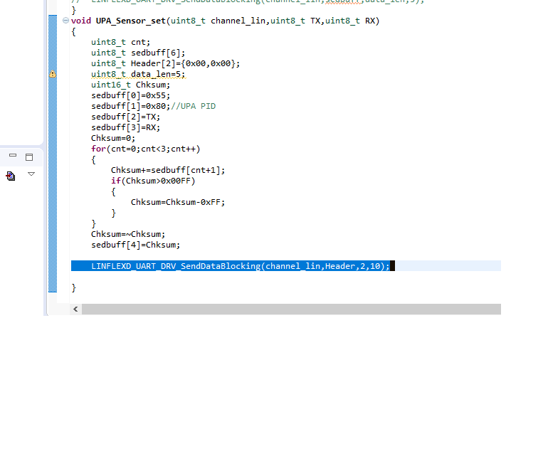

HI,
    I changed the demo project "interrupt_control_multicore_mpc5748g",in my project I added two lin,one is in Z40,the other is in Z41.The PIT_Ch0 in Z40 don't work when the lin works in Z41.I work well ,when I comment out the following statement
please help!
1,046 Views
petervlna
could you be more specific?
What exactly is doing your INTC controller? As there is only one INTC you cannot execute more than 1 interrupt in a time.
It doesn't really matter which core serves external interrupt from INTC.
How should I understand this message? Is your PIT interrupt working fine if LIN interrupt is disabled? or?
