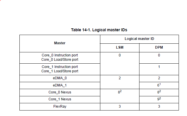

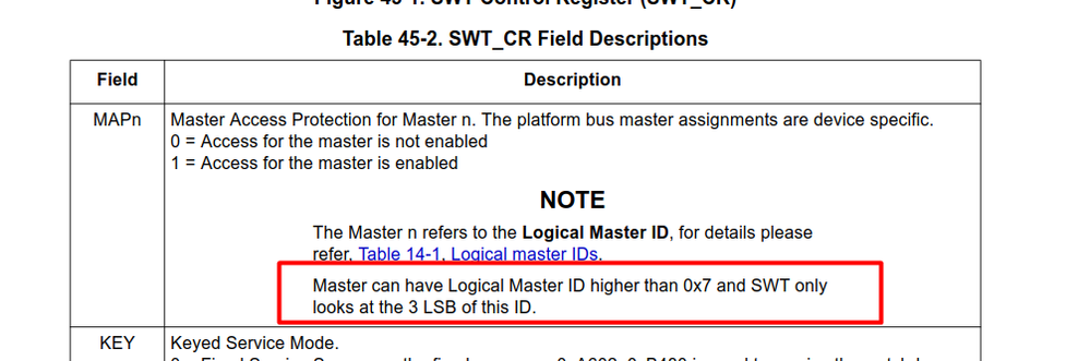

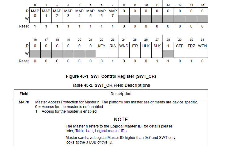

I am analysing software watchdog timer of MPC5643L. In that, Sotware control register has 8 bits of Master access protection in which the enabling and disabling of master access is done. But for that, the logical master IDs of crossbar
is referred. How to refer logical master ID as there are 9 master IDs in which logical master ID 4 and 5 are not used.logical ids.PNGregister.PNG

Hi, an answer you may find in the same screenshot, you have attached.
In other words - there is no difference between core and nexus accesses from SWT point of view.
