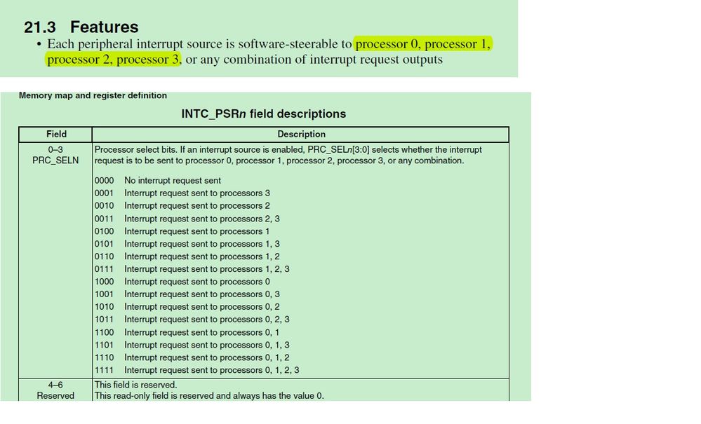

the pic above is in MPC5744P RM. I wander what does that mean processor0/1/2/3?
Does  processor0 means  the Main Core_0?
processor1 means  the Checker Core_0s?
no processor2/3 in MPC5744p?
and because in MPC5744p  the Checker Core_0s operates in lock step mode. So PRC_SELN must be set 1000b(Sent to processor0)
do i understand correct?  thank you very much!

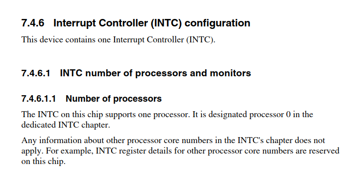

I believe following screenshot from reference manual answers your question:

fyw
Thank you very much!
