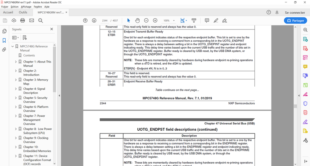

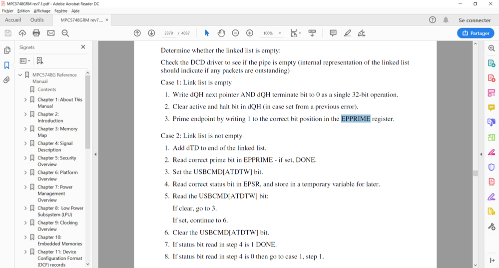

I'm trying to realise the USB device driver but i'm facing an issue. In the reference manual, at multiple locations, there is /are a reference to a register called
-"ENDPRIME"
-"UOTG_ENDPRIME"
-"EEPRIME"
but i dont find it/them in the document. It seems like this/these register is used in other NXP mcu using the USB stack. Please see bellow screenshots.
I'm working with this document :  "MPC5748G Reference Manual, Rev. 7.1, 01/2019"
Could you help with this topic please?
Thanks in advance.
Madjid
