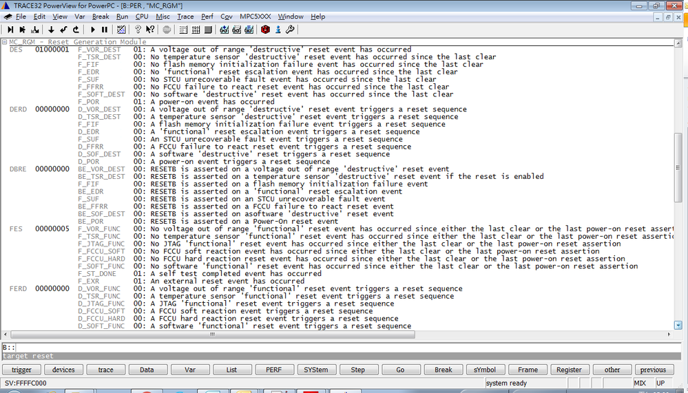

From your DES register I can see that your voltage was out of range.You need to measure the power supply pin  VDDHV while reset occurs.
I expect some drops on supply voltage which caused your reset. Maybe weak power source.
You can also apply external power from regulated power supply to exclude any drops\peaks in voltage.
If you want to write code just test DES and FES registers and based on fault detected take actions.

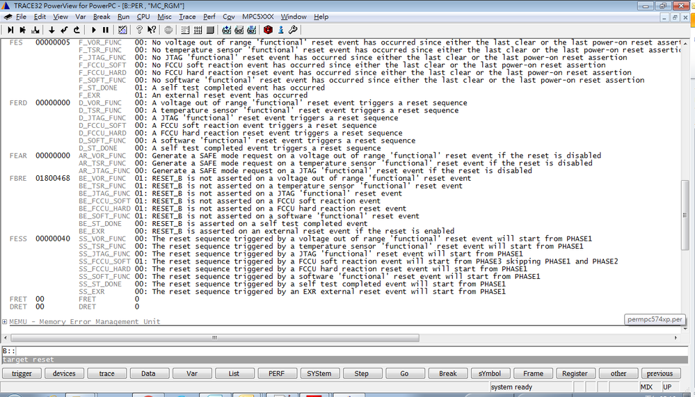

i use the trace32 debug tools to see the MC_RGM
but  i want to use code to test the which reason reset,
and fccu to detect the xtal fail,vcc ovp,....

First of all tell me what is "always doing reset"?
1. Device is in permanent reset
2. Is reseting in intervals?
Is it possible to connect with debugger?
There is no test code for reset reasons.
You can write it according to ISO demands for your target safety class.
If it is possible to connect with debugger I suggest you to check FES and DES registers in RGM(reset generation module) for reset reason.

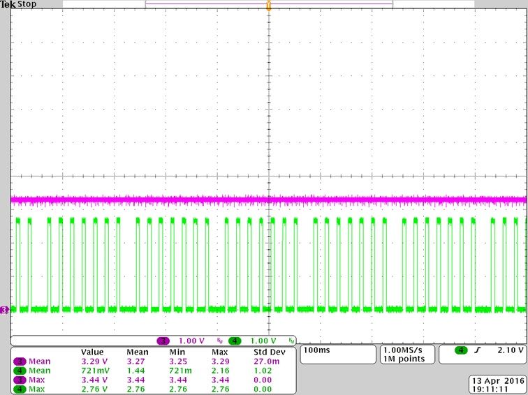

MPC5742P RESET PIN(31)

jaureshsieh
I had check the 33907,that reset reason from 5742p,33907 not do reset!
