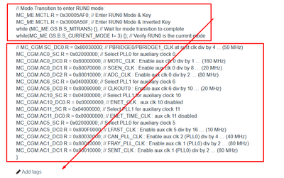

when I from boot jump into app ,I find the peripherals like can ,adc can not work,but led blink succeeful。I guess it's because of the clock configuration,help me find the reason.below  is my codes.
app clock configuration
void MC_MODE_INIT(void)
MC_CGM.AC3_SC.B.SELCTL = 0x01; //connect XOSC to the PLL0 input
MC_CGM.AC4_SC.B.SELCTL = 0x01; //connect XOSC to the PLL1 input
// Set PLL0 to 400 MHz with 40MHz XOSC reference
PLLDIG.PLL0DV.R = 0x58021014; // PREDIV = 1, MFD = 20, RFDPHI = 2, RFDPHI1 = 11
MC_ME.DRUN_MC.R = 0x00130070; // RUN0 cfg: IRCON,OSC0ON,PLL0ON,syclk=IRC
// Mode Transition to enter RUN0 mode:
MC_ME.MCTL.R = 0x30005AF0; // Enter RUN0 Mode & Key
MC_ME.MCTL.R = 0x3000A50F; // Enter RUN0 Mode & Inverted Key
while (MC_ME.GS.B.S_MTRANS) {}; // Wait for mode transition to complete
while(MC_ME.GS.B.S_CURRENT_MODE != 3) {}; // Verify RUN0 is the current mode
// Set PLL1 to 200 MHz with 40MHz XOSC reference
PLLDIG.PLL1DV.R = 0x00020014; // MFD = 20, RFDPHI = 2
MC_ME.RUN_PC[0].R = 0x000000FE; // enable peripherals run in all modes
MC_ME.DRUN_MC.R = 0x001300F4; // RUN0 cfg: IRCON, OSC0ON, PLL1ON, syclk=PLL1
MC_CGM.SC_DC0.R = 0x80030000; // PBRIDGE0/PBRIDGE1_CLK at syst clk div by 4 ... (50 MHz)
// MC_CGM.SC_DC0.R = 0x80030000; // PBRIDGE0/PBRIDGE1_CLK at syst clk div by 4 ... (50 MHz)
MC_CGM.AC0_SC.R = 0x02000000; // Select PLL0 for auxiliary clock 0
MC_CGM.AC0_DC0.R = 0x80000000; // MOTC_CLK : Enable aux clk 0 div by 1 … (160 MHz)
MC_CGM.AC0_DC1.R = 0x80070000; // SGEN_CLK : Enable aux clk 0 div by 8 … (20 MHz)
MC_CGM.AC0_DC2.R = 0x80010000; // ADC_CLK : Enable aux clk 0 div by 2 … (80 MHz)
MC_CGM.AC6_SC.R = 0x04000000; // Select PLL1 for auxiliary clock 6
MC_CGM.AC6_DC0.R = 0x80090000; // CLKOUT0 : Enable aux clk 6 div by 10 … (20 MHz)
MC_CGM.AC10_SC.R = 0x04000000; // Select PLL1 for auxiliary clock 10
MC_CGM.AC10_DC0.R = 0x00000000; // ENET_CLK : aux clk 10 disabled
MC_CGM.AC11_SC.R = 0x04000000; // Select PLL1 for auxiliary clock 11
MC_CGM.AC11_DC0.R = 0x00000000; // ENET_TIME_CLK : aux clk 11 disabled
MC_CGM.AC5_SC.R = 0x02000000; // Select PLL0 for auxiliary clock 5
MC_CGM.AC5_DC0.R = 0x800F0000; // LFAST_CLK : Enable aux clk 5 div by 16 … (10 MHz)
MC_CGM.AC2_DC0.R = 0x80030000; // CAN_PLL_CLK : Enable aux clk 2 (PLL0) div by 4 … (40 MHz)
MC_CGM.AC1_DC0.R = 0x80010000; // FRAY_PLL_CLK : Enable aux clk 1 (PLL0) div by 2 … (80 MHz)
MC_CGM.AC1_DC1.R = 0x80010000; // SENT_CLK : Enable aux clk 1 (PLL0) div by 2 … (80 MHz)

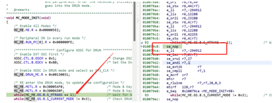

recently ,I even tried to use same block init code  in boot and app project(The screenshot at the bottom is my code).I still dont know why the progress of programe  is stuck here
It  mean  mode can not  transition from drun to drun .Than I test set boot use RUN0 ,app use DRUN, that do not work also.
Does this mean that the two projects cannot use the same clock setting?

petervlna
No. Two projects can use the same settings. There is no limitation.
The mode transition is usually stuck due to fault in FCCU [NCFSx] register or clock is still supplied to some module (CAN for example) and need to be terminated before mode transition.
If the peripheral is still actively clocked, mode transition will fail.
Last but lest possible is that PLL is not stable. (weak power source, wrong clock configuration).

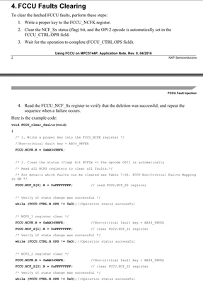

shaoduoduo_3-1670468821363.pngshaoduoduo_3-1670468821363.pngshaoduoduo_4-1670468838055.pngshaoduoduo_4-1670468838055.png
I debug the project .
It seems that status bits in FCCU NCF,location at 0XFBF58080,is 0.
lastly,power source on board didnt changed.
Shaoduoduo
4,052 次查看
petervlna
Ok. For reading faults of FCCU NCFSx registers you ahve to apply the procedure. Hope you are aware of that, otherwise you will always read 0 even if there are faults latched.
petervlna_0-1670478531841.pngpetervlna_0-1670478531841.pngpetervlna_1-1670478556156.pngpetervlna_1-1670478556156.png
Peter
4,047 次查看
shaoduoduo
thank you Peter,I find this in AN5284.It's very difficult for me to catch this error because the app programe run ok when it work independently.
