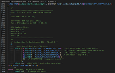

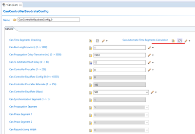

When I select the auto-calculation option in MCAL, the generated code makes the sample point 70%.
How can I config it to make the sample point as 80%?
What is the correct way to config the CAN sample point as 80%?
With the generated MCAL code, my calculation for CAN sample point is as follows.
NBT = BTL =  (SYNC=1) +  (PROPSEG=3 +1) +  (PSEG1=1 +1) + (PSEG2=2 +1) = 10
SJW = RJW=1 +1 = 2
Sample point = (NBT - PSEG2) / NBT =  7/10 = 70%

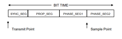

Sampling point is given by point between Phase_seg1 and Phase_seg2.
I can offer CAN timing calculator helping you to configure it properly:
https://community.nxp.com/t5/MPC5xxx-Knowledge-Base/MPC5xxx-S32Kxx-LPCxxxx-CAN-CAN-FD-bit-timing-cal...
