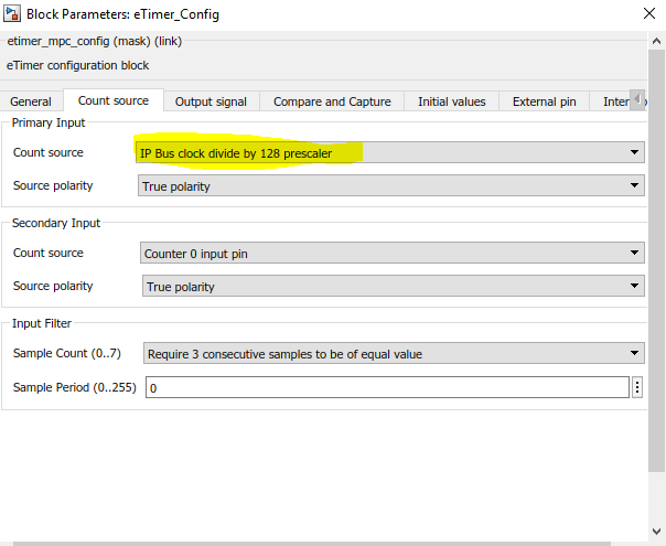

Hi everyone
Currently I am using MBDT (Simulink) for programing NXP-MPC5744P
when using eTimer I do not know what is IP Bus clock frequency in eTimer_Config window.
in this window I can just select prescaler and there is no option for choosing IP Bus frequency
I just want to know how can I configure clock in Simulink?
In  microcontroller configuration block, as you can see, I just can select 200 MHz and I do not know how to access PLLs?

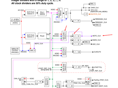

I am not familiar with MBDT but I will explain how clocking works for eTimer.
eTimer is supplied by MOTC_CLK as reference manual states:
So for setting MOTC_CLK you need to configure Auxiliary Clock 0 Divider 0 Configuration Register
(MC_CGM_AC0_DC0):
And also you need to know clock supply for AUX0, this is defined by your setting of MC_CGM_AC0_SC
So configure divider of your MOTC_CLK according to your needs, this is your eTimer clock.
Peter
