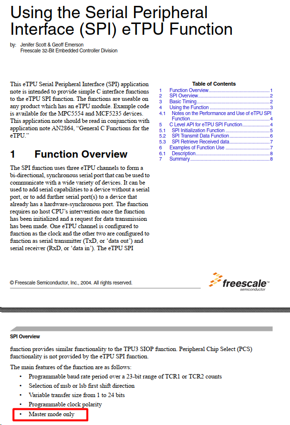

1) eTPU function selector https://www.nxp.com/webapp/etpu/ contains example only for eTPU SPI master mode function. Example code for mpc5777c contains only binary etpu micro-program in the etpu_code array variable and I have no ideas how to change it to adopt eTPU SPI to slave mode. (no pseudo-code or another logic that can be translated to binary code) But it is required etpu spi slave mode api/example. Can you provide me the slave mode etpu SPI api/example?
2)  Also etpu-c spi example for mpc5777c doesn't contain some files mentioned in the readme.txt (fetched form downloaded zip-archive) - util\init_template\etpu_gct.c, util\init_template\etpu_gct.h
3) Document related with eTPU SPI - AN2847 contains the references to the some source code files (spi_ppc_example.h, spi_ppc_example.c, spi_mcf_example.h, spi_mcf_example.c, spi_mcf_example_global_etpu_gct.h, spi_mcf_example_global_etpu_gct.c) that are absent in target zip-files.

Hi, eTPU SPI function offers only master mode.
2,063 Views
johndiener
An enhanced SPI eTPU driver that supports both master and slave configurations can be found at GitHub - jddiener/SPI-eTPU: This project is a SPI eTPU driver that includes many enhancements beyond... .
