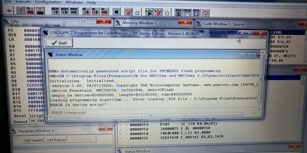

      The question is that  file(.mcp) can not be loaded into processor(mpc5607B), the information of error is follow: TXJG6836[1].jpg
1,015 Views
martin_kovar
.mcp is file for CodeWarrior project. This file cannot be loaded into microcontroller. Please use .elf or .mot file.
