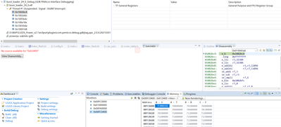

    I am developing CAN Bootloader for MPC57485G. There some issue.

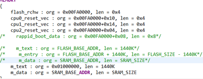

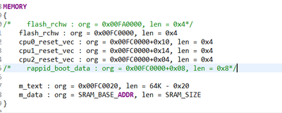

bootloader:
app:
my jump code:
However, after __asm__("se_blrl"), the debug show as follow:
It shows "No source available for "0xfc0400" . Could anyone help me?

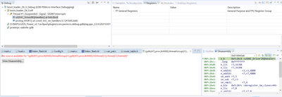

And,I add clean RAM before jump, It will show as follow:
Is uSDH IRQ? But I have disable IRQGlobal, and I never use uSDH.

I2C driver uses OSIF, you can find it in referenced components. It looks like configured PIT channel is still working. I2C_MasterDeinit() does not disable selected timer and INT_SYS_DisableIRQGlobal() clears MSR[EE] bit only. So, please check the OSIF/PIT. I guess that this could be the reason.
