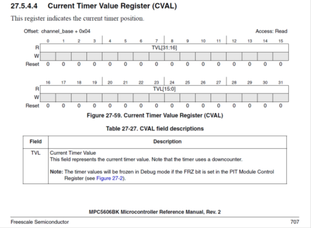

I searched in the reference manual and there is no notice about reading CVAL. But I recommend you to read TIF flag. This is correct way, how to check that timeout was reached.
In the second case, when you check CVAL, it seems the PIT counted is too fast and the condition in while loop is still true (you miss the moment when CVAL is equal to 0) and this causes the problem with delay.

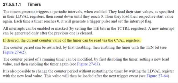

Initially, I also thought the same that somehow due to speed mismatch While() is not getting executed properly.
Then I tried this condition also while((PIT.CH[0].CVAL.B.TVL) <= 25){};
But still it is not working. This means speed mismatch should not be the case.
I need to read CVAL value to calculate speed of the motor by reading CVAL values in different interrupts.
Here, It is mentioned that we can read the CVAL value, But I want to know what is correct way to read CVAL?
