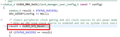

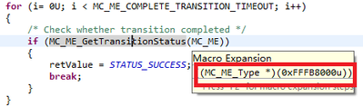

There is a requirement is that keep an IO high level when APP jump to the bootloader, so it is not feasibile to enter Bootloader by software reset.
It is normal for the first time to enter APP from Bootloader.I deinitialize all peripheral such as PIT, SPI before entering bootloader and bootloader will enter APP again. When MCU enter APP from bootloader for the second time, it will stuck at initialzing. I used the library functions offered by IDE. These pictures shows how I find the problem.
1.I find it stuck at here.

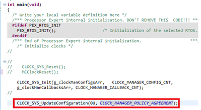

2.Then stuck at here in picture 1 function

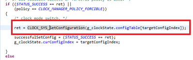

3.Then stuck at here in picture 2 function

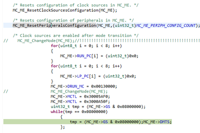

4.Then stuck at here in picture 3 function

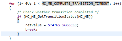

5.And finally I found here. It seems that the cycle is waiting a register status until timeout.
6.Then I checked the address of this register, and found out what is the cycle wating for.
But I dont know why this bit stuck at "Mode transition is on going ". Besides, I tried to reduced the TIMEOUT value in picture 5, then the project will stuck at initializing PIT, or SPI, or the others peripheral.

OK, so I expect you still have some peripheral active which is sourcing the clock like CAN or PWM.
Gate clocks to those, usually the peripherals have in control register freeze bit so similar.
Peter

petervlna
You mode transition is stuck because you have active some periphery which is supplied by PLL.
Try to do mode transition to IRC clock and then to your application settings.
Make sure all peripherals are not clocked by you application clock when you request mode transition.
Peter
3,267 Views
LuoSi
I've tried as you said.I reset MC_RUN_PC_n, MC_LP_PC_n and ME_PCTL_n before requesting mode transition but  mode transition is still stuck.
A register called MC_ME_DMTS as the picture below can see what state is currently. The value is the picture below when the stuck happen. But it is not clear to me that how to find the cause of stuck. Could you help me analyze it?

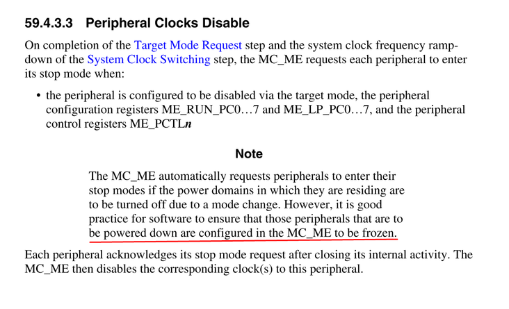

petervlna
Peter
