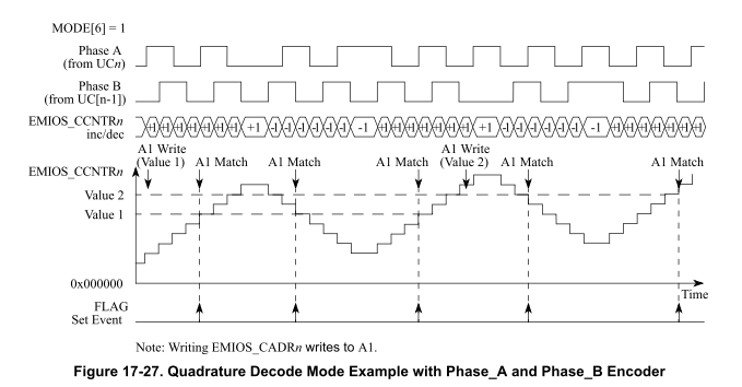

diagrams shown in the reference manual are the best ones to understand how it works:
I also found very simple testing code in my repository - see attached. You can connect respective signals to pins (the best way is to use very slow signals or manually controlled signals) and then watch the effect in EMIOS registers to understand the functionality. The example is written for count and direction encoders type but it doesn't matter, it works in similar way.
Lukas

Yes, CCNTR is automatically updated. You can connect the signals from encoder to the pins and watch the CCNTR. No other settings are required.
The CCNTR is updated in the same way regardles of mode - you will see the same effect also when using Phase_A and Phase_B Encoder.
