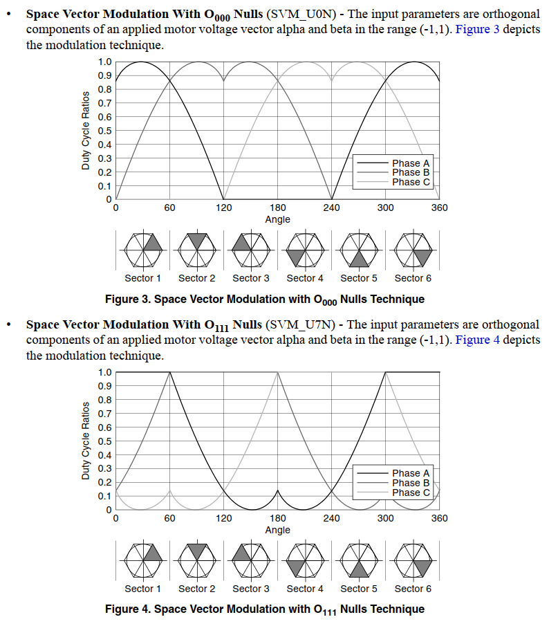

  I am using the first one method in my implementation but I want to know the difference between the two.

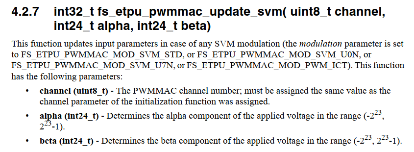

The main question is when I am using the STD mod SVM API , we need to feed alpha & beta to the API. But only feeding this, it wont work... after multiplying some constant to alpha & beta it is working fine. So is this correct?

Yes, I understand it this way.
The difference you may see in the following pictures:
