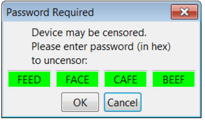

Hi Everyone,
I have successfully censored my micro MPC5643L using NVSCI=0x55AA55A0 and kept the default password=0xFEEDFACECAFEBEEF. When I use code warrior 10.6 with the JTAG that I have PEMicro it will ask for the password before starting the debug session like this:
and I could get into the debug session and flash memory is accessible. But using code warrior 11.1 it will show me this message:
I don't know where to put the -uncensorpassword=FEEDFACECAFEBEEF in to access the micro or where is that GDB server parameters, Could you please help with this?
 Thanks in Advance,
