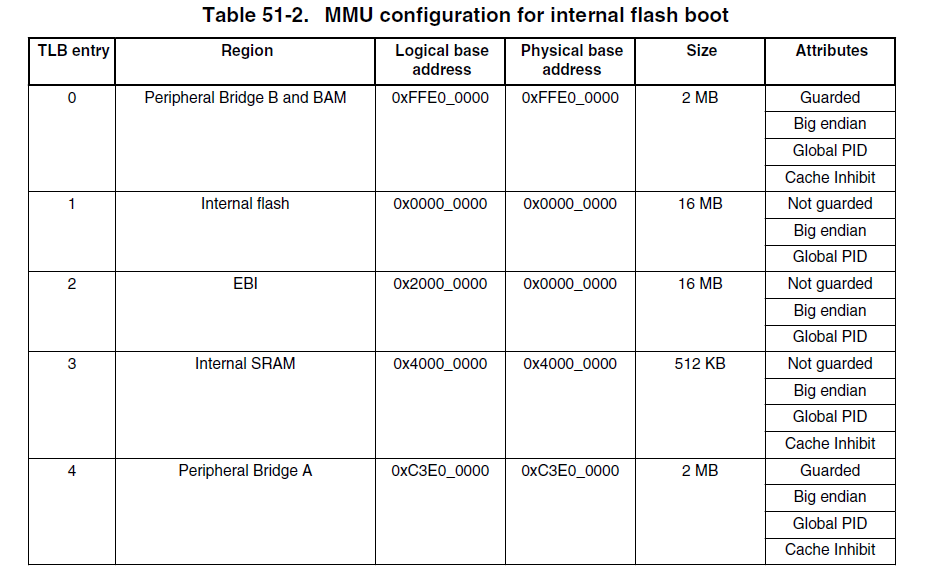

I am playing around with TLB for MPC5777C. Booting from internal flash it looks like this:
So I remapped the TLB entry 1 by doing this:

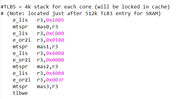

If you are using the same startup as me, then it uses portion of cache for stack and it occupies TLB5:
I would recommend to show MMU table by the debugger to check what is real configuration  during runtime.

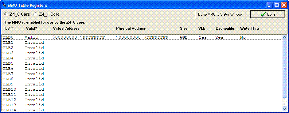

I would love to see the MMU table but I do not know if I can do this with my crappy debugger (not using Lauterbach unfortunately).
Mathias
2,242 Views
davidtosenovjan
Even simple debuggers should be able to show MMU table, for instance PeMicro debugger presents it this way.
