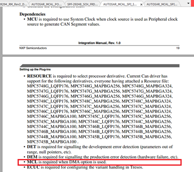

Hi Team,
We are configuring SPI communication using DMA for reading and writing data from/to EEPROM. while configuring SPI with DMA ,references for SpiPhyTxDmaChannel (SpiPhyUnit),SpiPhyRxDmaChannel (SpiPhyUnit) and SpiPhyTxDmaChannelAux (SpiPhyUnit) these parameters are not available. As per parameter description and our understanding references for these parameters has to come from MCL module.
In out tool we don't see MCL module ,we would like to know whether we should get MCL module plug-in and static code from NXP.
Could you please help on these query ASAP.

Hello @RuturajKhandare ,
[Hung] Yes, could you please add the MCL module. If user use the DMA, the MCL is needed. Please check the "eclipse\plugins\Spi_TS_T2D35M10I1R0\doc\AUTOSAR_MCAL_SPI_IM.pdf" for more information.
Hung.
