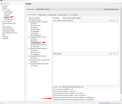

Hello All,
I am trying use sprintf and snprintf in our code. But after sprintf function, code got hanged. It's not executing the next line of the code.
Please help me to resolve this issue.

I had a similar problem.And in the project properties,I found C/C++ build->Setting ->C Linker -> Miscellaneous ,Check to support print float format.

there are few SDK based examples within S32DS where sprintf is used. Refer e.g. to
- ic_pal_mpc5744p
- fccu_fault_injection_mpc5744p
- ammclib_mpc5744p
