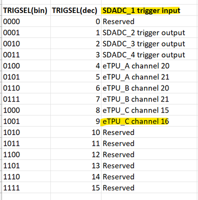

Example code you may find here:
Example MPC5777C-SDADC_eTPU_triggered GHS714
https://community.nxp.com/docs/DOC-335360
However let’s talk about SDADC a bit -
Once enabled the SDADC keeps running. There is no “Single conversion mode”. This requires converted data to be continually drained by DMA or ISR. The digital nature of the SDADC means that there is a propagation delay as the data is clocked through the internal digital filters. This has to be taken into account at startup or at any channel mux change. This latency means that the SDADC is not well suited to some applications including motor control. When used in an AC sampling application it is likely that each SDADC will have to be dedicated to a particular input rather than switching the input channel.
SDADC offers higher conversion accuracy (16-bit result).
SDADC is always combined with other type of ADC, on this device it is eQADC offering advanced triggering and channel multiplexing capability (on other MPC57xx device SDADC is supplemented by SAR ADC).
So I would recommend you to use eQADC module for single triggered ADC conversions.

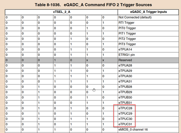

Understood, because I want only a single scan I am okay to use eQADC but then will I be able to trigger the ADC read when there is a rising edge on ETPUC16 pin? Because I don't see an option of ETPUC16 being a trigger for eQADC. Is my understanding correct?
Tags (2)
338 Views
davidtosenovjan
No there is no such option there. Pay attention to register SIU_ISEL4 and above:
