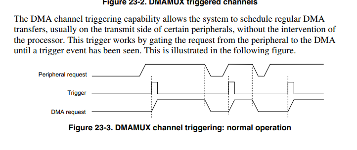

yes, i agree with you ,i should use the PIT channel 0 , i tried ,but it seems still one time DMA transmit, i dont know why,
finding  some hint ,but i still cant figure this out ,may be i miss some part of configuration, you can see this in details Page 744 from UM.
i  do follow the part of DMA channel with the triggering capabilities.
2. is there any way to trigger DMA transmit mutiply times except the PIT ways?
3. from the picture ,we can see if we wanna trigger the DMA request mutiply, it need two condition
one is the Trigger ,that is PIT timers , two, meanwhile , there need a Peripheral request when Trigger happened at the this time ,
so i think if  lack a peripheral request when PIT works, but how (now im using SPI TFFF)?

if you do not require to send data periodically in given intervals, you do not need to use PIT triggering.
DMA request for SPI transmission is asserted anytime when transmit buffer is not full. You can check this SW example:
https://community.nxp.com/docs/DOC-334012
It is written for another device and there's no DMA_MUX but it shows DMA settings, at least.
You are supposed to write only one word to PUSHR register per one DMA request. So, NBYTES should be set to 4, CITER and BITER should be number of words you want to send.
If you configure it in this way, I believe it will work (with or without PIT trigger, both should work).
