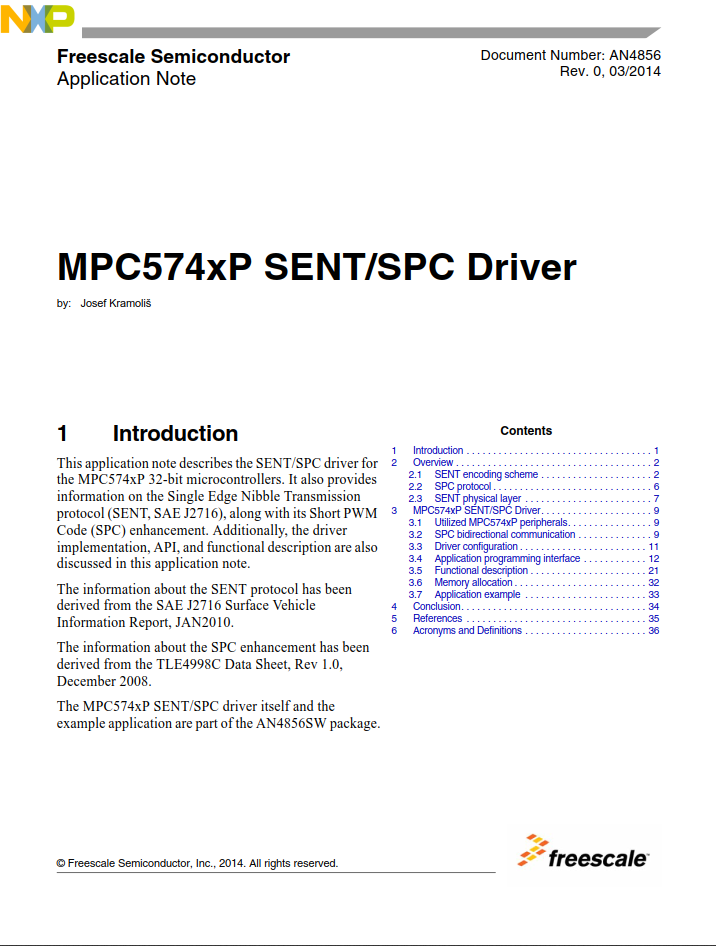

on MCU MPC5744P, I need SENT module software driver,thanks.

I've found an old configurator for getting a SENT Driver
See in the Application Note and the file.
I have problems with getting the Makro running with Excel 2010. Is there a newer version of the Macro available?
https://community.nxp.com/external-link.jspa?url=https%3A%2F%2Fwww.nxp.com%2Fdocs%2Fen%2Fapplication...
https://www.nxp.com/docs/en/application-note/AN4856.pdf

There was an application note describing the SENT interface and referring to an Excel-Makro sheet, which generates a driver with all necessary .h and .c-files. I couldn't find it anywhere on the Internet. It would be great if NXP could provide it again with a good demo example in S32 Studio.
Here's snapshot of the Document:

I have asked responsible persons and
looks like we do not offer SENT driver for MPC5xxx in SDK neither in AUTOSAR.
