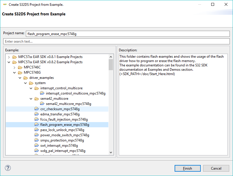

Hello everyone !
Seek for an example of using the SDK for MPC5748G Flash read/write.
Thanks in advance.
Best Regards.

martin_kovar
there is example included directly in S32 Design Studio v2017.R1. Please check the figure below.
Martin
