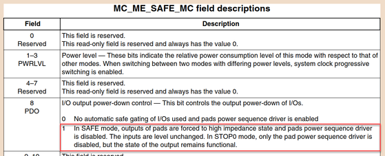

Certainly yes, but it is needed to realize that during SAFE mode, device is clocked by IRC what’s may affect communication peripherals.
Also pay attention to following note
I don’t think there would be an issue to debug in TRACE32 when device is in SAFE mode.

Apparently this bit should not be set.

MC_ME_SAFE_MC[PDO] should be writable, unlike other modes. So I would see it as a configurator issue.

If PDO bit is on, ECU is entering into low power mode
Now, i can able to debug from trace32. After disabling the PDO bit.
