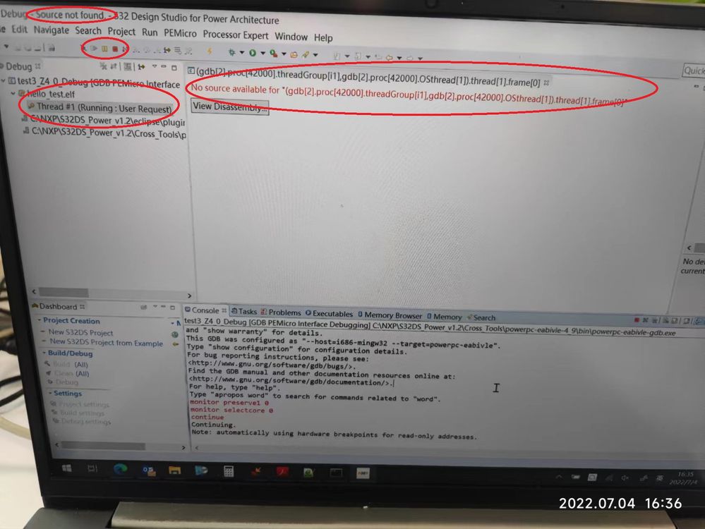

The ELF file generated by compiling mpc5748g source code with GHS multi is loaded in s32ds (version 1.2), and the following interface is displayed after debugging. It cannot be debugged. What is the reason? How to solve it?

Hi, please pay attention to following thread and all links it points to:
https://community.nxp.com/t5/S32-Design-Studio/How-to-import-Greenhills-generated-files-into-S32D-an...
I believe it answers your question.

According to the method of the link you gave, it is still the same as the above display. The source code and debug cannot be displayed
