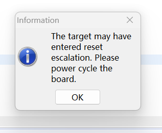

The board we designed using MPC5777C encountered the following errors in the first debugging, and the measurement reset pins were always low:
1、“The target may have entered resetescalation. Please power cycle the board.”

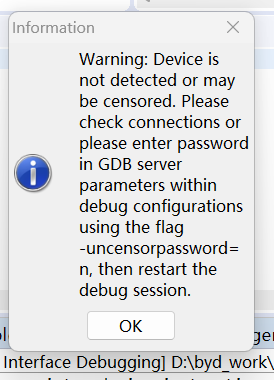

2、“Warning: Device is not detected or may be censored. Please check connections or please enter password in GDB server parameters within debug configurations using the flag-uncensorpassword=n, then restart the debug session.”

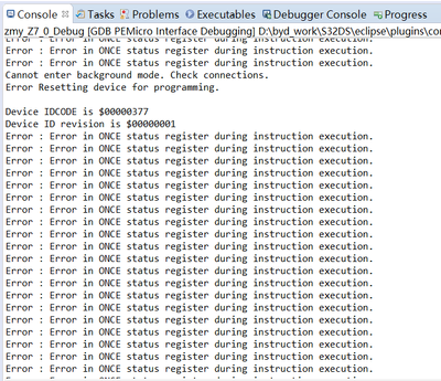

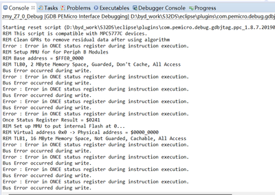

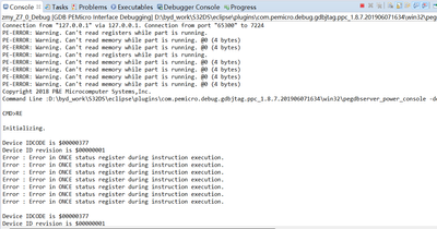

The following is the log during the debugging process:
Connection from "127.0.0.1" via 127.0.0.1. Connection from port "65300" to 7224
PE-ERROR: Warning. Can't read registers while part is running.
PE-ERROR: Warning. Can't read memory while part is running. @0 (4 bytes)
Copyright 2018 P&E Microcomputer Systems,Inc.
Command Line :D:\byd_work\S32DS\eclipse\plugins\com.pemicro.debug.gdbjtag.ppc_1.8.7.201906071634\win32\pegdbserver_power_console -device=MPC5777C -startserver -singlesession -serverport=7224 -gdbmiport=6224 -interface=USBMULTILINK -speed=5000 -resetdelay?
CMD>RE
Initializing.
Device IDCODE is $00000377
Device ID revision is $00000001
Error : Error in ONCE status register during instruction execution.
Error : Error in ONC...
