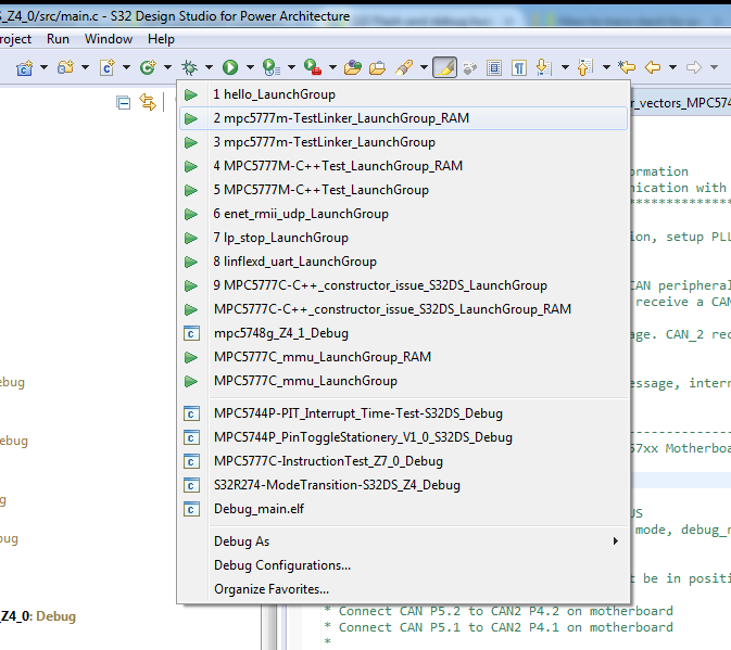

martin_kovar
are these two elf files created by S32DS or by different IDE?
If you have multicore project created by S32DS, you can simply use LaunchGroup option to load and debug.
If you want to load and debug elf files which does not come from S32DS, please see article below and use point 3. Instead of single core project, create multicore project and use it's debug configuration (LaunchGroup configuration).
HOWTO: download separate elf/srec file to microcontroller using S32 Design Studio
I suppose these two elf files are files for different cores and I suppose you have correctly created linker files.
