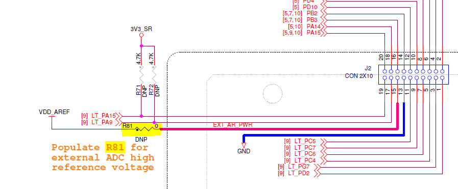

just a little question: where can I find the pads for resistor R81 on the DEVKIT-MPC5744P board (Rev. X2)? I'd like to use an external ADC reference and I really cannot find the location of the solder pads. (And not only me...)
Any help is greatly appreciated.

it should be just next to J2 header
BR, Petr
