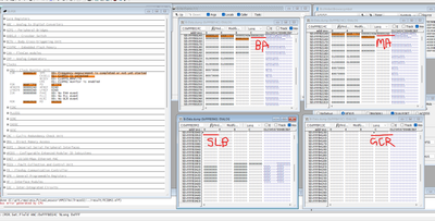

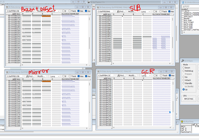

These are the Modules on which I am implementing Locking mechanism under Register Protection for MPC5746C.
    0xFFFB0140, /* CMU------------*/
    0xFFFB0040, /* FXOSC----------*/
    0xFFFB0180, /* MC_CGM --------*/
    0xFFFB8000, /* MC_ME ---------*/
    0xFFFA8000, /* MC_RGM --------*/
    0xFFF50000, /* MEMU_0 -------*/
    0xFFFB0080, /* PLLDIG --------*/
    0xFFFA0400, /* PMCDIG --------*/
    0xFFFC0000, /* SIUL2 ---------*/
    0xFFFB0100, /* SXOSC ---------*/
    0xFFF9C000 /* LPU_CTL -------*/
    1. Sample 1: (0xFFFB0000, offset - 0x4, 32-bit protection)
Register: Matches ME_MCTL (mode control register, 32-bit protection, offset 0x4 per Table 77-5).
Base Address: 0xFFFB0000.
Protection Size: 32 bits (all four bytes are protected).
Calculations
Normal Address: base + offset = 0xFFFB0000 + 0x4 = 0xFFFB0004
Mirrored Address (Area 3): base + 0x2000 + offset = 0xFFFB0000 + 0x2000 + 0x4 = 0xFFFB2004
Soft Lock Bits Address (Area 4):
Offset in Area 4: offset/4 = 0x4 / 4 = 0x1.
Address: base + 0x3800 + offset/4 = 0xFFFB0000 + 0x3800 + 0x1 = 0xFFFB3801.
For a 32-bit register, all four SLBs (SLB0–SLB3) control the four bytes (e.g., 0x4 to 0x7).
Soft Locking
Option 1: Write to Mirrored Address:
Write a 32-bit value to 0xFFFB2004 (e.g., 0x80000000 to initiate a mode transition; refer to MC_ME chapter for valid values).
This updates ME_MCTL at 0xFFFB0004 and sets SLB0–SLB3 in the SLBRn register at 0xFFFB3801.
Example: *(volatile uint32_t *)0xFFFB2004 = 0x80000000;
Option 2: Direct SLB Write:
Write to 0xFFFB3801 to set SLB0–SLB3.
Write 0xFF (WE0–WE3=1, SLB0–SLB3=1) to lock all four bytes.
Example: *(volatile uint8_t *)0xFFFB3801 = 0xFF;
Unlocking
Write 0xF0 to 0xFFFB3801 (WE0–WE3=1, SLB0–SLB3=0) to clear SLB0–SLB3, unlocking the register.
Example: *(volatile uint8_t *)0xFFFB3801 = 0xF0;

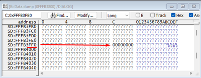

Hard Locking
Write 0x00000001 to 0xFFFB3FFC to set GCR.HLB, locking SLBs until reset.
Example: *(volatile uint32_t *)0xFFFB3FFC = 0x00000001;

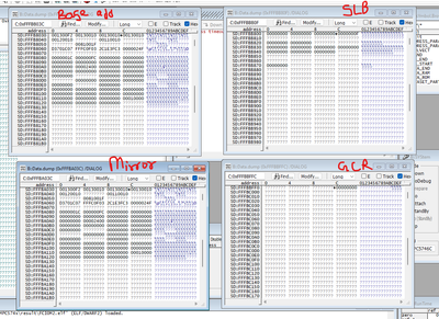

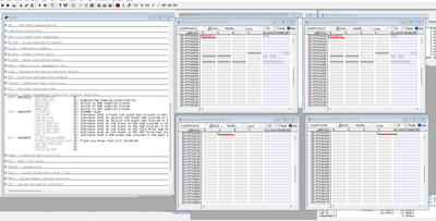

Below in an example of register set whose all 4 address set are enable and can be R/W.
Below in an example of register set whose Base + offset & Mirror addresses are enabled and can be R/W and other addresses can’t be set.
This poses a serious issue as SLB bits confirms soft locking and GCR bits are set to implement hard lock.
For All MC_CGM caped registers I can find the same problem.
What could be the reason for these different behavior. Some addresses can be modified and changed other are reserved.

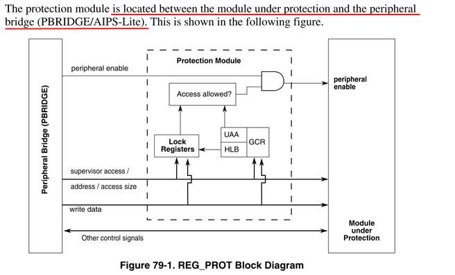

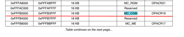

petervlna
if I Hard lock any one module , all other modules are getting hard locked automatically, which raises issue in Low power mode. since I do not want FXOSC/SXOSC and CMU to be hard locked here.
The register protection is applied Pbridge.
And on the PBRIDGE is the MC_CGM module:
Which have then mapped peripherals under MC_CGM. Looks like you will need to use SLB instead of HLB to solve this.
As HLB will lock whole MC_CGM.
Peter

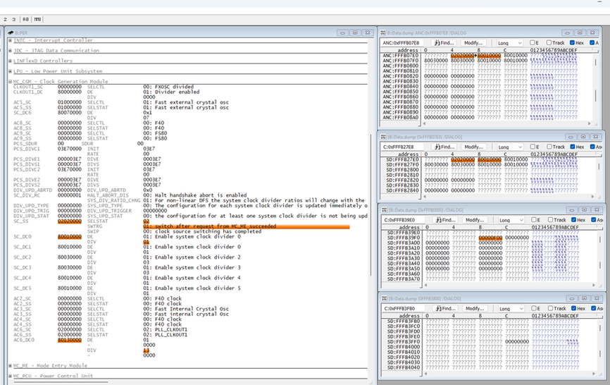

I have checked the PREG_PROT and it behave like described in reference manual:
on ME_CGM register SC_DC0:
Base :  0xFFFB0000 + Offset 7E8
Mirror: 0xFFFB07E8
= Base (0xFFFB0000) + Offset(7E8) + Mirror (0x2000)
In the example I have locked the SC_DC0 form ME_CGM module by Soft lock.
Here is the breakdown:
Area 4:  is 1.5 KB and holds the Soft Lock Bits, one bit per byte in area 1. The four Soft Lock Bits associated with one module register  word are arranged at byte boundaries in the memory map. The Soft Lock Bit registers can be directly written using a bit mask.
So you have to divide the area of Soft lock bits by 8 to see corresponding SLB settings.
Base (of module) + 3800 + (one bit per byte of area 1)
For Hard lock bit it is one for whole module.
Area 5 is 512 bytes large and holds the configuration bits of the protection mode. There is one configuration hard lock bit per module that prevents all further modifications to the Soft Lock Bits and can only be cleared by a system reset once set. The other bits, if set, will allow user access to the protected module.
Base (of module) 0xFFFB0000 + Offset 3FFC
As GCR is at end of area 5.
Peter

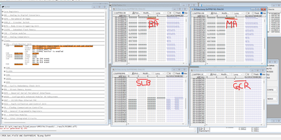

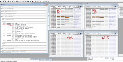

Hi Peter , here are some samples where SLB and GCR are not working.  can You please check this addresses and confirm if they show different behavior. if not then what could be the problem with these modules ?
1. MC_CMU -  0xFFFB0140 -  { MODULE_CMU, 0xC,REG_SIZE_16}, CMU_LFREFR
    1. Base Address - 0xFFFB014C
    2. Mirror Address -0xFFFB214C
    3. SLB -0xFFFB3943
    4. GCR - 0xFFFB413C
2. MC_CMU -  0xFFFB0140   { MODULE_CMU, 0x18,REG_SIZE_32}, CMU_MDR
    1. Base Address - 0xFFFB0158
    2. Mirror Address - 0xFFFB2158
    3. SLB - 0xFFFB3946
    4. GCR - 0xFFFB413C
3. PLLDIG 0xFFFB0080 - { MODULE_PLLDIG, 0x20, REG_SIZE_16}, PLLDIG_PLLCR
    1. Base Address - 0xFFFB00A0
    2. Mirror Address - 0xFFFB20A0
    3. SLB - 0xFFFB0F5D
    4. GCR - 0xFFFB407C
4. PLLDIG 0xFFFB0080 - { MODULE_PLLDIG, 0x28,REG_SIZE_32}, PLLDIG_PLLDV
    1. Base Address - 0xFFFB00A8
    2. Mirror Address - 0xFFFB20A8
    3. SLB - 0xFFFB388A
    4. GCR - 0xFFFB407C
5. PMCDIG 0xFFFA0400 - { MODULE_PMCDIG, 0x0,REG_SIZE_32},
  1. Base Address - 0xFFFA0400
  2. Mirror Address - 0xFFFA2400
  3. SLB - 0xFFFA3C00
  4. GCR - 0xFFFA43FC
6. PMCDIG 0xFFFA0400 -{ MODULE_PMCDIG, 0x10,REG_SIZE_32},
    1. Base Address - 0xFFFA0410
    2. Mirror Address - 0xFFFA2410
    3. SLB - 0xFFFA3C04
    4. GCR - 0xFFFA43FC

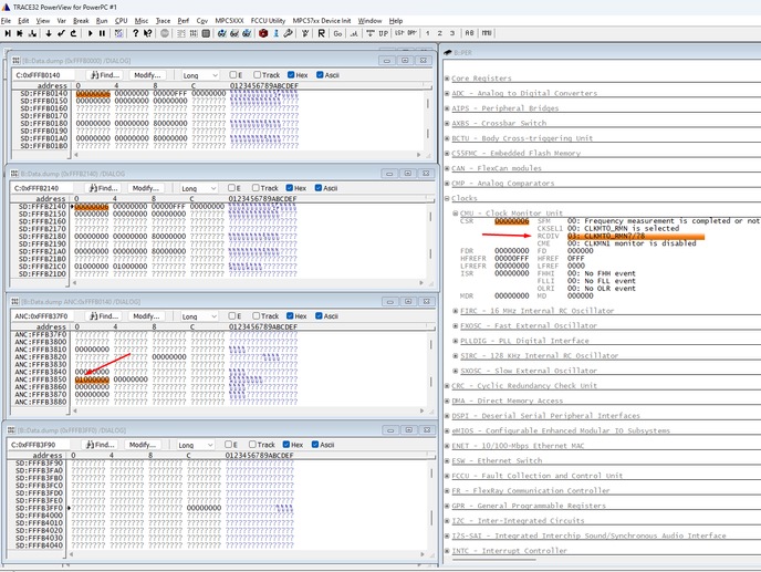

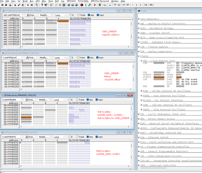

Looking at simple test: MC_CMU - CSR
Base Address - 0xFFFB014C - This is offset address. Not Base.
Base for MC_CMU module is 0xFFFB 0140.
Would be base +offset + mirror
SLB -0xFFFB3943
Take as base address of whole CGM as present in ref manual:
So calculations are:
0xFFFB0000 + 3800 + position of SLB
GCR - 0xFFFB413C
Same as above
0xFFFB0000+3FF0
Peter

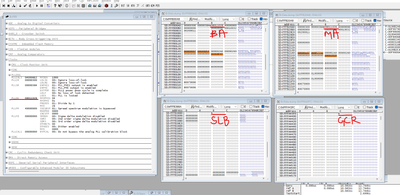

Here is the result of SLB for
CMU_LFREFR 32 -  addresses base and offset
Base for CGM module is  0xFFFB_0000
CMU offset is 0x140
CGM LFREFR offset is 0x14C from module base
I set SLB for CMU_LFREFR via write to mirror
Peter
