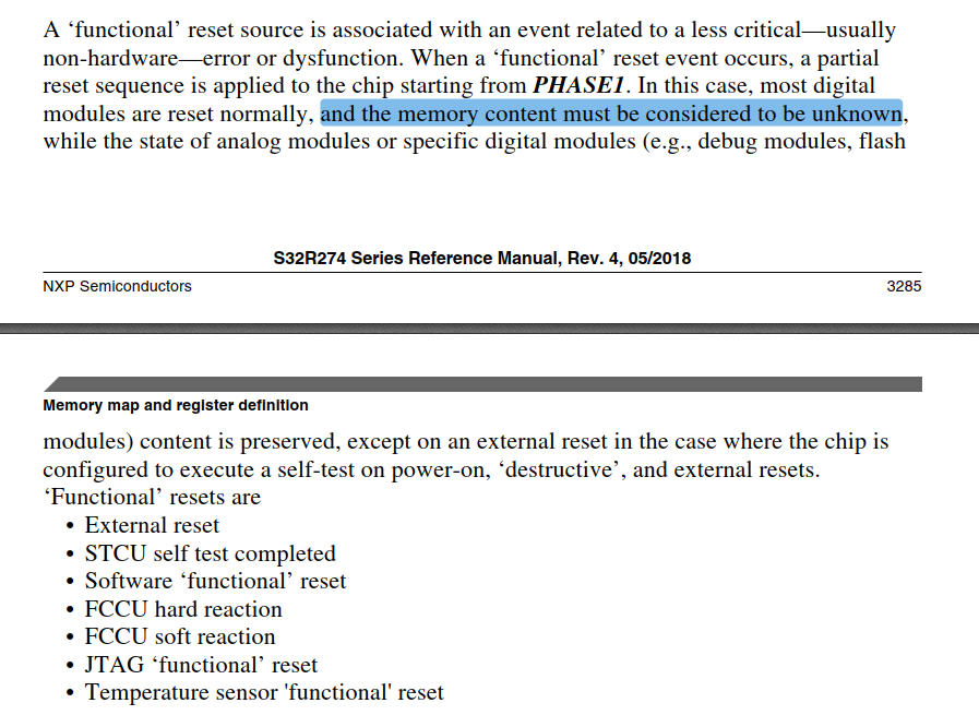

hello:
 I have divided a piece of SRAM in the App program(MCU: S32R274), which will be initialized once only when the power on. other reset conditions are not initialized. the purpose of this is mainly for som information interaction between bootloader and App. However, after i do this, the first function reset of the app will be ok, but when i do the second function reset, a BUS_DRERR(Read bus error on data load or linefill) will be generated, the RGM_DES.F_EDR = 1,RGM_FES.F_ST_DONE = 1 , RGM_FES.F_SOFT_FUNC = 1,  why is this?
reset command :
   MC_ME.MCTL.R = 0x00005AF0 ;
   MC_ME.MCTL.R = 0x0000A50F;
   while(1); // wait reset

Hi, according to the reference manual, I would say it is not possible to do it so on this device.

   But why is the first function reset possible?
   In addtion, I think where can the information shared between bootloader and application be stored? Are there any good Suggestions, such as how can we know whether it is the power reset,app jump or other resons for reset into bootloader?

HI, I have heard core register USPRG0 may be used for the purpose.
