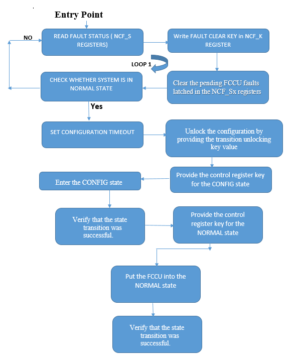

santoshkumar_n
Hello Peter,
Thank you for your response.
The below discussion is the continuation of discussion item 1 (Discussed in the previous reply)
As you told I agree with your point that "FCCU abort state and reset state does not have much correlation".and we confirmed by deep debugging.
My initialization sequence is attached as JPEG with this thread.Please have a look.
While on debugging i find the following:
1. During POWER ON RESET & GO, the above flow works good  and FCCU IS FUNCTIONING NORMALLY.
2. Down the line, When I give a SOFTWARE RESET via DEBUGGER, " System RAMs uncorrectable ECC error" is been generated
    and i confirmed inside the MEMU ERROR Registers also.
ANY idea /guidence WHY THE  "System RAMs uncorrectable ECC error" is getting generated ...?
3.  If i continue " GO( Execute the code in debugger )" after the above scenario, i find that the Control/Execution enters the code as usual via the entry point as depicted in above figure, but gets stuck inside the LOOP 1 and I observe the following
      *.   FCCU STATE is in " FAULT STATE". ( The reason could be the generation of the RAM ERRORS & could not be erased by the status                  clear operation)
      *    The  Execution keep continuing inside the LOOP 1 shown in above figure ( The reason could be the FCCU STATE is in " FAULT STATE")
      *   The FCCU. CTRL .OPS = ABORT. (Not able to find out WHY THE  operation result(OPS) turned to ABORT..?
Could you please help us to get the ANSWERS for the above..?
Note: From reference Manual page no 2792
The ABORT response occurs in the following cases:
  • wrong access (missing or wrong key) to the FCCU_NCF_S register (clear operation OP12)
  • wrong access (missing or wrong key) to the FCCU_CTRL register (OP1, OP2 operation)
  • OP1 (CONFIG command) execution when FCCU state /= NORMAL or configuration locked
  And I cross checked we did not do any of the above malfunctions in loop 1.
5,482件の閲覧回数
petervlna
Hi:
I expect that you are not disabling BIST. It is enabled by default in our factory. Memory BIST is executed during reset and destroy the ECC content of RAM memories as BIST is not executed via standard bus interface.
Therefore the RAM must be initialized every time the memory BIST is executed.
I expect that you initialize RAM only after POR or destructive reset. But it must be initialized also after long external reset. Only reset which do not triggers BIST is reset starting from phase 3  ( short external reset).
This is my guess, but without further information I cannot tell you any closer details.
To point 3:
You have to distinguish between fault report and fault source.
You can clear this fault in FCCU by standard fault clearing procedure. However it is immediately set again as its source line is still active (MEMU ECC flags). Therefore you think it is not cleared.
1. remove the fault source(MEMU) and then you can clear the fault in FCCU.
This should be because of:
1. you are checking it with debugger and CONFIG state watchdog timeout.
2. You are not able to enter config state because of pending fault. (Not all fault prevent entering the config state).
Working with FCCU is quite tricky, therefore I have published various application notes  to help customers with it.
But debugging via community is always hard :smileyhappy:
Peter
PS: upload me here your latest compiled SW (at least output file) so I can play with it to see if there is an issue. :smileycheck:
