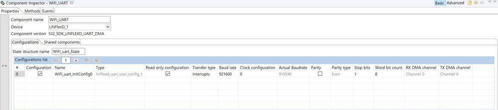

hello
I have a question.
Data is exchanged using 921600 UART (About 500Byte ~ 1000Byte)
When using CAN-FD, there is a phenomenon that stops due to UART Data Loss.
I want to use DMA to solve that problem.
UART uses LINFlexD_1, and RX DMA Channel and TX DMA Channel are fixed to 0 in Processor Expert.
The above RX_DMA_Channel or TX_DMA_Channel is different from the channel number of the DMA controller.
Question 1.
- Is it okay if RX_DMA_Channel and TX DMA Channel of LINFlexd1 are different from Channel Number of DMA Controller? (Attach the picture below)
processor_exp_DMA.JPGprocessor_exp_DMA.JPGprocessor_exp_UART.JPGprocessor_exp_UART.JPG

PetrS
1) in LinflexD_1 component you need to select "DMA" as transfer type, then you will be able to choose RX and TX DMA channels, which have to be different. In DMA component you should have again 2 channels added, with same channel number as selected in LinflexD_1 component.
2) it is enough to call EDMA_DRV_Init before LINFLEXD_UART_DRV_Init as you have.
BR, Petr

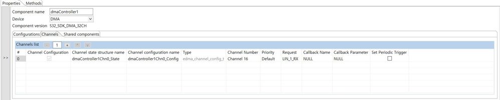

cskwon
Thank you for answer. @PetrS
The question was being edited.
Changed UART to use DMA in Processor Expert,
The DMA channel and the UART DMA channel are matched.
processor_exp_UART.JPGprocessor_exp_UART.JPGprocessor_exp_DMA.JPGprocessor_exp_DMA.JPG

PetrS
not sure how do you use your WiFi_UART_Callback. But in case of DMA transfer, still you should install RX callback to have indication of complete reception. DMA channel setting is done in driver, also it installs DMA callback etc.
However if you are going to receive just 1 byte, DMA usage does not bring any benefit. Go through ReceiveData function to see how it is handled.
Call this function with expected number of bytes to be receive, and after whole bytes will be received RX callback should be invoked with RX buffer filled by DMA.
BR, Petr
