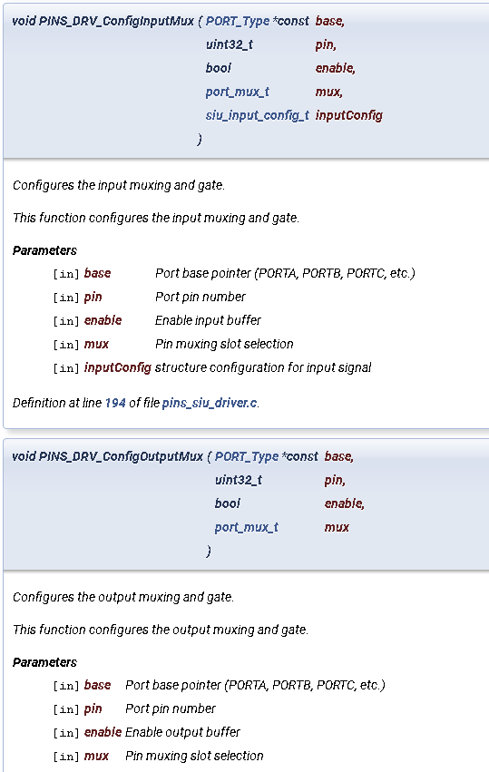

  I'm working with MPC5775E in S32 studio (FreeRTOS SDK),
By selecting the PinMux functional properties I can set the pin mode as either OUTPUT or INPUT. But I need to change the mode during run time, in order to write and read the same pin. Is there any API available for setting Pin Mode ?
2,928 Views
lukaszadrapa
there are following functions:
And here is an example from hello world project:
Lukas

Hi Lukas Zadrapa,
                            I'm trying to mimic I2C on MPC5775E using bitbang method. for that i need two gpio's(SCL,SDA) in which one is continued to be used as output, the other one has to be set as output and input during runtime to read the ACK signal from the slave.
for example

I need to know whether there is any api to set PIN MODE in our s32ds. please reply if u can help me out.
2,928 Views
lukaszadrapa
the "mode" of GPIO is controlled by input buffer enable bit IBE and by output buffer enable bit (OBE) in SIU_PCRn registers. This can be done using the functions mentioned above. Notice output buffer and input buffer can be enabled at the same time.
And also notice that GPIO can be configured as open drain using ODE bit in SIU_PCRn register. So, in fact, you don't need to reconfigure the pins in runtime.
