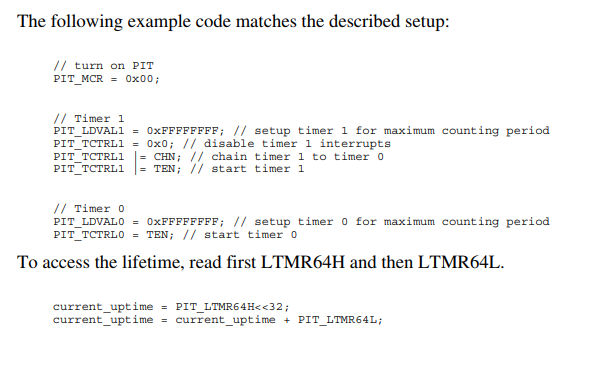

i try activate timer on SPC5748GH and use example, but in first command PIT_MCR = 0; i got exception(invalid memory). Can you help me.
Tags (2)
1,180 Views
lukaszadrapa
it looks like you haven't enabled the peripherals in Mode Entry module. You can take a look at:
Example MPC5748G PinToggleStationery GHS614
See function System_Clk_160mhz().
