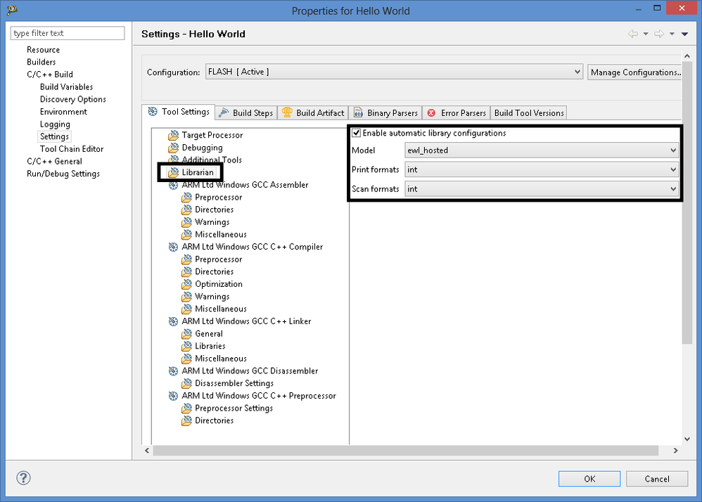

Alternatively, if you don't want to bother with any UART setup, you can download CW 10.4 SE and use the ewl_c_hosted (a.k.a. "Debugger Console") option when you go through the new project wizard and are prompted for the I/O options.  This will send all printf output to the "Console tab".

I pulled down the CW 10.4 SE and tried to create a new Bareboard Project, but I'm never offered I/O options, ewl_c_hosted or otherwise, in the wizard.  Is there another way to access them?

Oh darn, maybe it's hardware specific.  For example, when working the Kinetis family of boards, there's this screen:
Are you able to see this screen if you right click on your project and select properties?
If not, then I guess the UART route will have to be pursued.
I hope this helps,
Rich
5,859 Views
matthewclark
Rich,
No, alas.  I don't have a "Librarian" option, at least for the bareboard project I'm trying to create.  I guess I'll have to do it the hard way.  Thanks.
Matt
