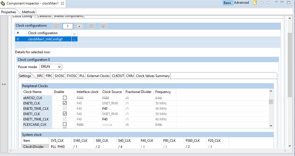

I need help adding Ethernet to the DEVKIT-MPC5748G. I configured all of the pins to exactly how the  lwip_mpc5748g demo but I can not make the clock configuration match. the demo has ENET0_CLK set to ENET_RMII with a frequency of 50 MHz. The one I created has the clock source set to F40 with a frequency of 40 MHz. What am I doing wrong? Is there any documentation on how to configure the ethernet?

Hi Matt,
have you enabled the external clock like this?

MattJCole
Contributor V
Thanks for the clarification. The difference between what you had and what the demo was setup scared me. I was afraid I would configure the ethernet in a way it would not work on occasionally and you know that kind of bug is a nightmare to debug. Also I hope you are felling better.

MattJCole
Contributor V
The demo for 3.0.3 doesn't match what you have in your setup. see attached picture. Is ENET0_CLK or ENET0_TIME_CLK supposed to have the clock source set to ENT_RMII

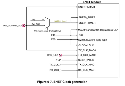

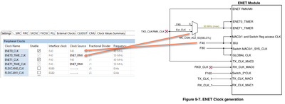

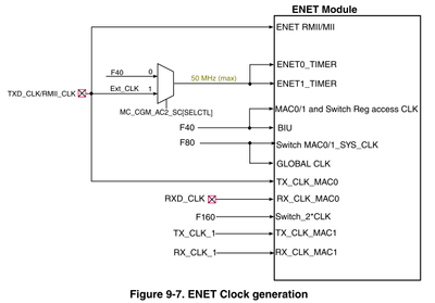

lukaszadrapa
I'm sorry for delayed response, I was out of office due to some health issues.
I will ask SDK team if they can fix this.
In fact, the only configurable clock is ENETx_TIMER:
If you have other clocks like F40 or F80 set to its maximum, there will be no problem.
The timer clock is then an auxiliary clock signal for the ENET module that is not needed for normal operation. It is used for IEEE 1588 Time-Sensitive Networking (TSN) applications, which our ENET module supports in hardware. This clock is specifically used for time-stamping IEEE 1588 datagrams.

MattJCole
Contributor V
That is enabled and the frequency is set to the correct value. I tried my best to make it match the LWIP demo but there are settings I can't  make match. I also get a warning when I set the PH1 Divider to /4 even though the demo has it configured that way. I attached my code. I hope you can figure out why I can not make my project match the demo.

lukaszadrapa
It looks like you used demo from SDK 3.0.0 for comparison, right? This one seems to be wrong, PHI1 needs to be 80MHz, so divider /8 must be used:
 I can see that this is fixed in 3.0.3. so the warning is correct. The same about ENET_CLK:
So, go on with your current configuration.
