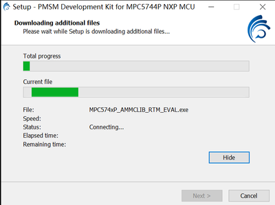

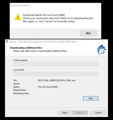

I have some difficulty in installing the  Motor Control Development Kit SW for NXPMPC574xP in the PC.When it turns to the step of downloading additional files,some problems will occur.Detailed information can be seen in the attached screenshots.

petervlna
For some reason the AMMCLIB link in this demo is not working.
Please uncheck the box of AMMCLIB in installation and download it separately.
