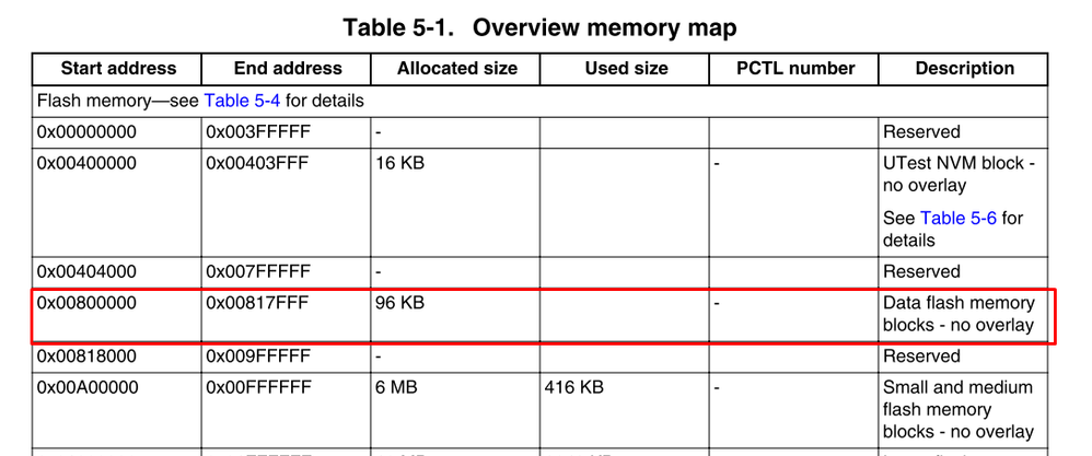

I  use the S32 DS power 2017 V2.1,
I want to  monitor some eeprom memory about mpc5744,but when i start to debug and panse debug, the memory window don't have anything ,as shown in the figure, i want to no why?
2,913 Views
petervlna
This is caused by access rights by requesting master or by Multibit ecc faults (which is not the case here I guess)
Could you describe this issue more closely as this memory area is accessible by default.
